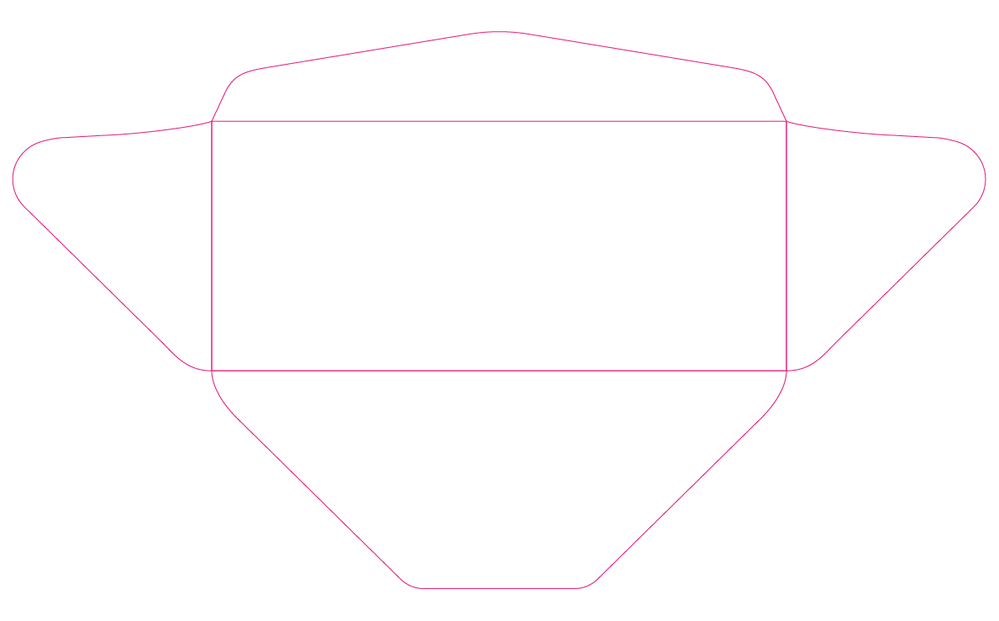

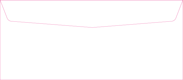

As an example, for a pre-litho envelope (where the paper is printed before it's converted to an envelope) they can supply you a dieline to use, or you can make your own in Illustrator (see example below for a no10 envelope). If they are sinmply able to print on both sides of a stock envelope, you can place an appropraite dieline so yo have a good guideline as to where to place copy. (second example). Make the dielines in illustrator with a spot colour called dieline and your printer can separate it in the prepress workflow.
