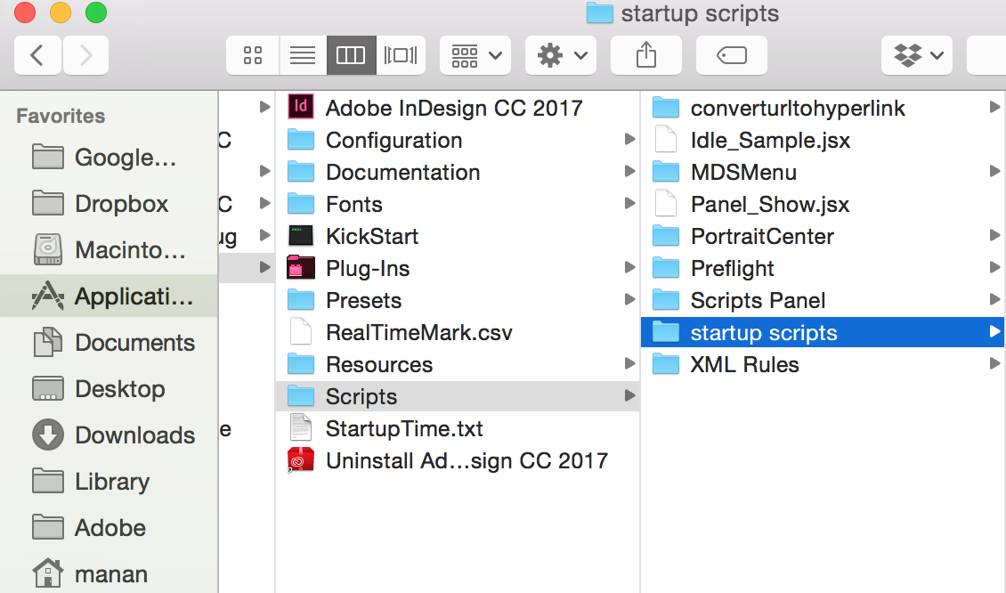

December 10, 2018
This menu item can be created by either a plugin or a startup script. First step would be to identify which of these is that.
  • Did you install any plugin recently, try removing that and see if it removed this menu
  • Check the same for any scripts that you might have installed, check the startup scripts folder look the attached screenshot and see if the said folder has any script present, if it has try remove that and see if the menu disappears
  • Also after doing the above two steps, try trashing the InDesign preferences http://www.tech4pub.com/2012/10/10/indesign-tip-reset-preferences-to-improve-performance/
Let me know how it goes.
-Manan
-Manan

December 12, 2018
So you mean to say you don't have any new plugin installed neither any startup script is installed? And you also trashed the InDesign preferences?
Lets verify it, could you please post a screenshot of the following
  • The contents Plug-In folder of InDesign.
  • The contents of the startup scripts folder
  • Also a screenshot of Window>Extensions menu in InDesign. I suppose a CEP extension can also add menu entries(not quite sure though, but never harms to check)
-Manan
-Manan
