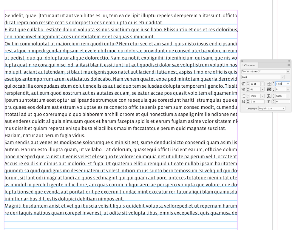

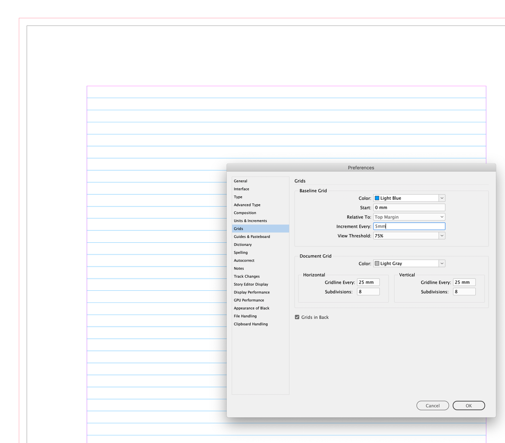

Hi @laurentc39824241 , it seems pretty easy to setup a baseline grid in millimeters. Here I’m setting up the document’s Ruler Units to Millimeters and the Baseline Grid to increment every 5mm starting at the margins:
If I set my text’s Leading to 5mm it aligns to the 5mm baseline grid as expected:

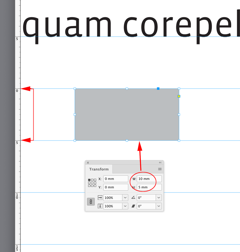

And a 10mm x 5mm frame aligning to the baseline with rulers set to Millimeters:

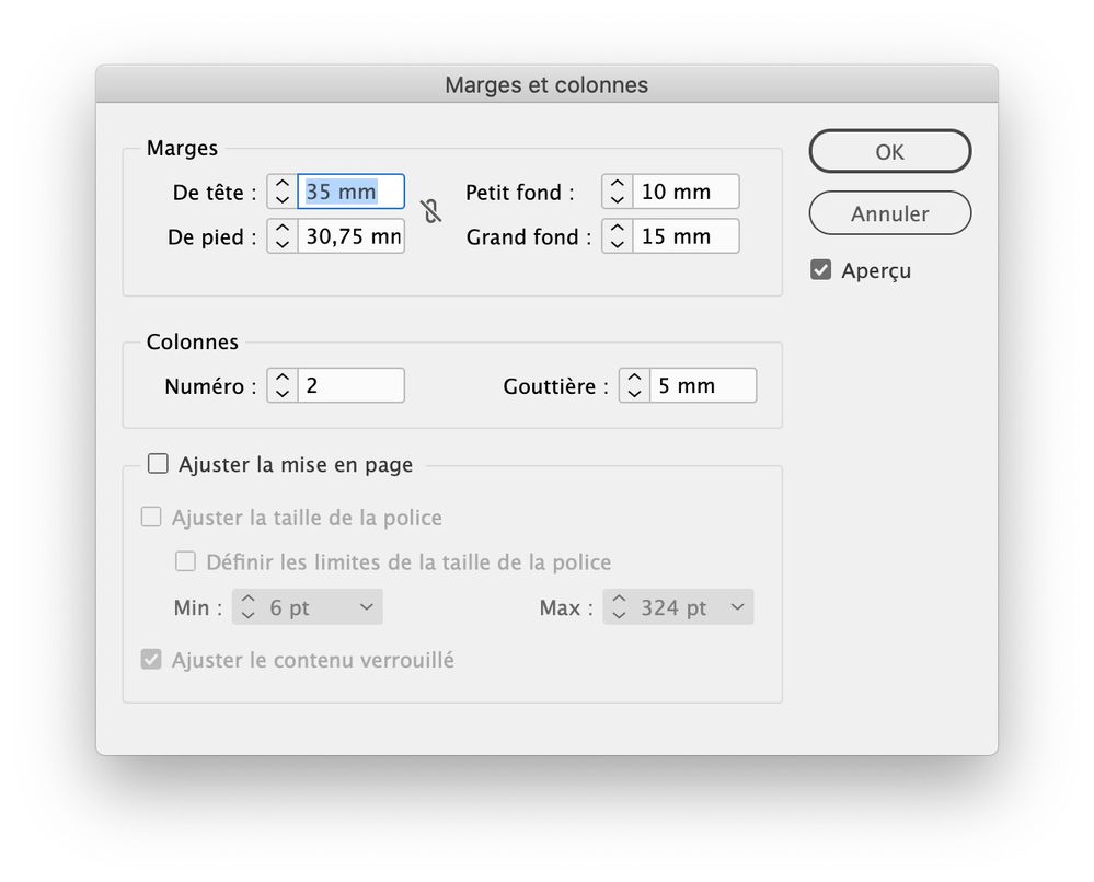

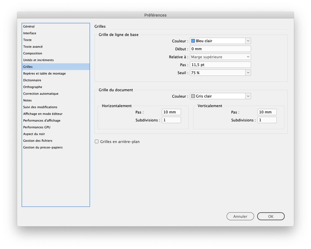

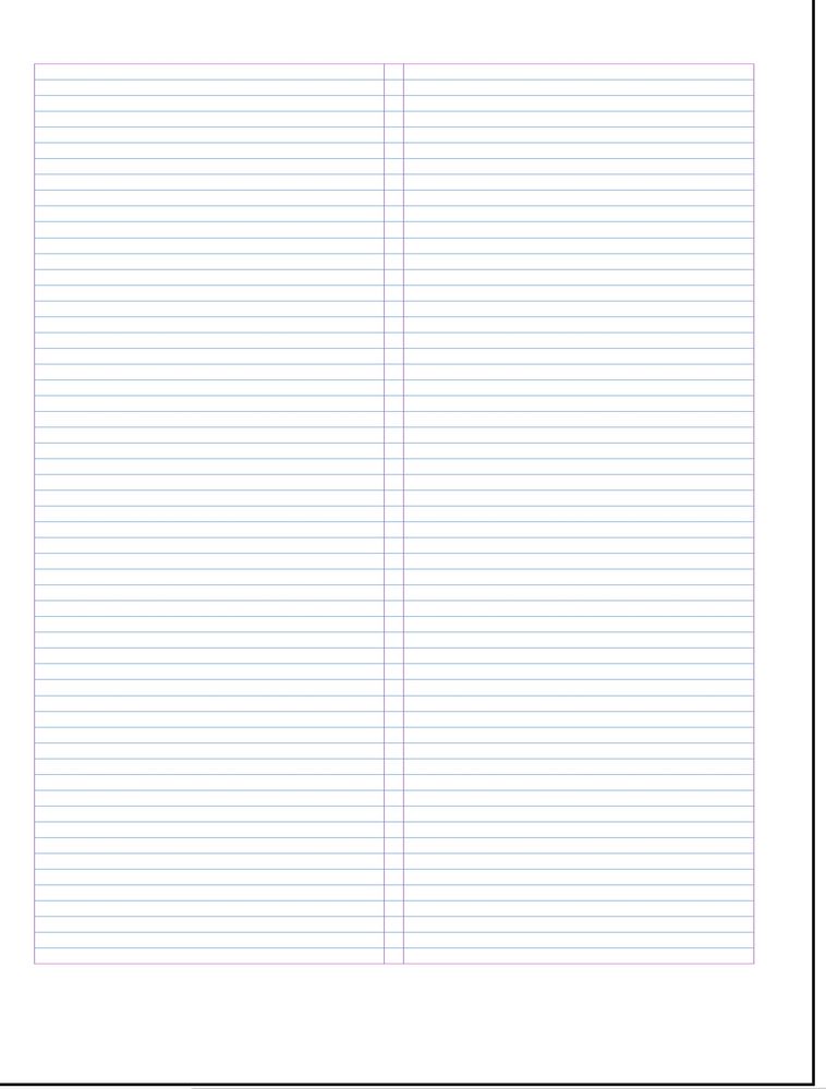

@laurentc39824241 Since type is measured and setup using points as unit, leading is also setup in points. So, the grid is also setup in points. Of course, that leads to difficulties to match the last line of the grid with the bottom margin. For my part, I measure the difference between the last line of the grid and the bottom margin, then I add this measure to the bottom margin. Of course, the bottom margin has no more integer values but it does not bother me…
In my screen shots, you can see the margin values of one magazine I design and the grid increment
