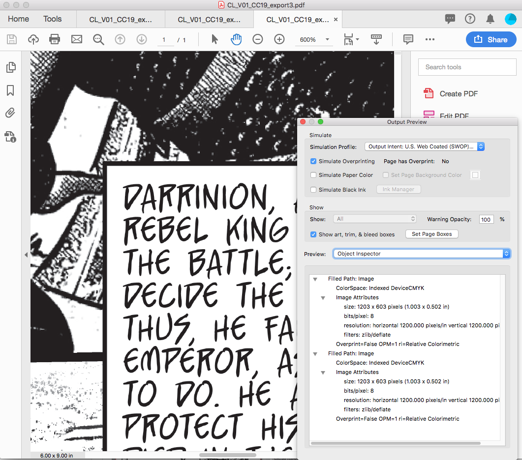

Hi Eugene, you can use ArcrobatPro's Object Inspector or Preflight to get an accurate view of the raster conversion.
There could be a case made for converting the text bubbles to 1200 ppi, 1-bit line art in order to cut down on file size, but doing that 1000+ times wouldn't be trivial, and I don't see how it improves the output—there's no appearance difference between 1200ppi grayscale B&W, and 1200ppi 1-bit—and that would make the text uneditable in ID. In the end it's the resolution of the text bubbles that matters.
Here's one of Robert’s pages flattened and rasterized, and I can use Object Inspector to check the resolution of the text bubbles. This complex page is only 4Mb!

When I looked at it, the text looked "gritty" in my screen. It may still look okay in print. I don't have a quality printer in my office to check it. I tweaked the preset a bit to have higher resolution for the rastered text, but then Amazon *didn't* take the file.
When you check the text in Acrobat zoom in to at least 800%, the grittiness might be from the low magnification when you are zoomed out.
What raster resolution did you use for the accepted file?
300. That's their preferred resolution. Works fine for images, but the text is definitely pixelated.
I re-exported at 1200. The text is clearly rasterized when viewed at 800%, but it's "fuzzy" rather than pixelated.
Right but you wouldn't see that in the print unless you looked at the text under a loupe. 300 is pretty low for black text, but it might fit in with the drawing style. It would be interesting to see if they would let 600ppi through.

It will be a few hours of processing (to export, upload, and run through Amazon's online checks). I'll try several PPI settings for the text, see what I can get through, and let you know.

I only suggested a high zoom level so Robert could compare the resolution difference.
Here is 300ppi on the left and 1200ppi on the right. At 100% you can't really detect the resolution difference, but at 800ppi you can. The difference between 300ppi and 1200ppi black text will show in print if the output device's res is higher than 300. The ideal resolution requirements for line art and text are higher than for a halftoned image

1200 PPI for the text breaks the Amazon system, but 600 PPI works. And it looks acceptable.
