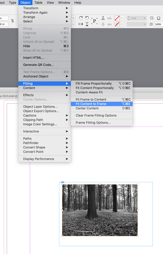

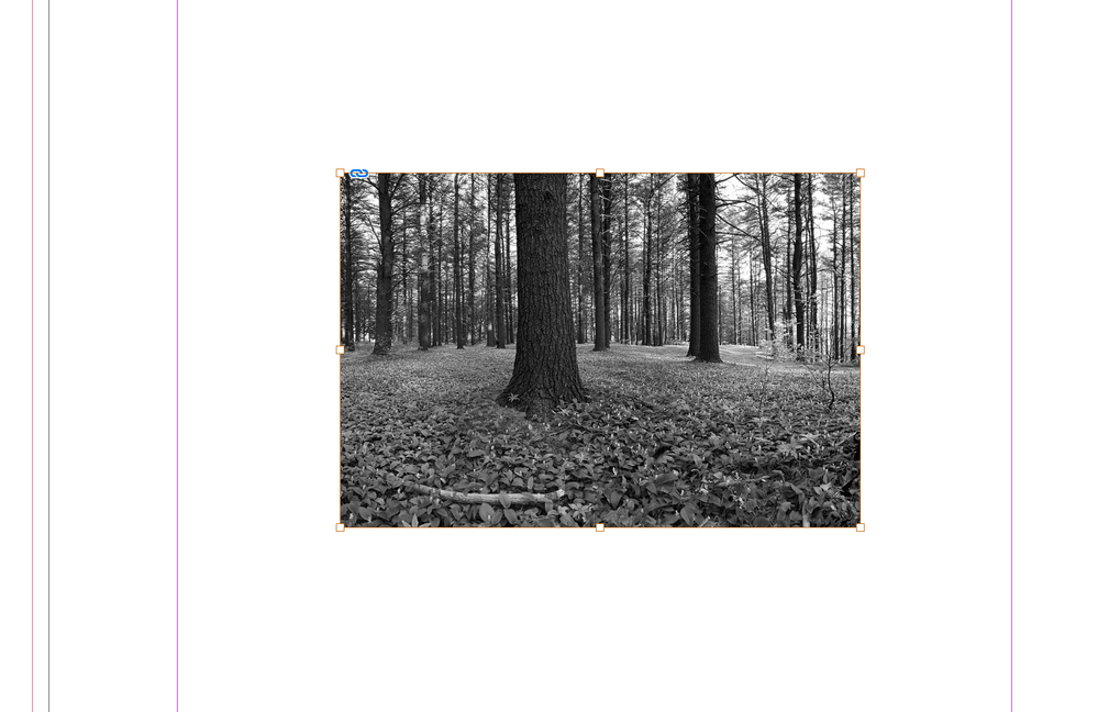

then I need to slowly adjust the image to fit the new container dimensions that it is inside
 Hi @paulg18077112 , Have you tried Object>Fitting>Fit Content to Frame, or Fit Content Proportionally?
