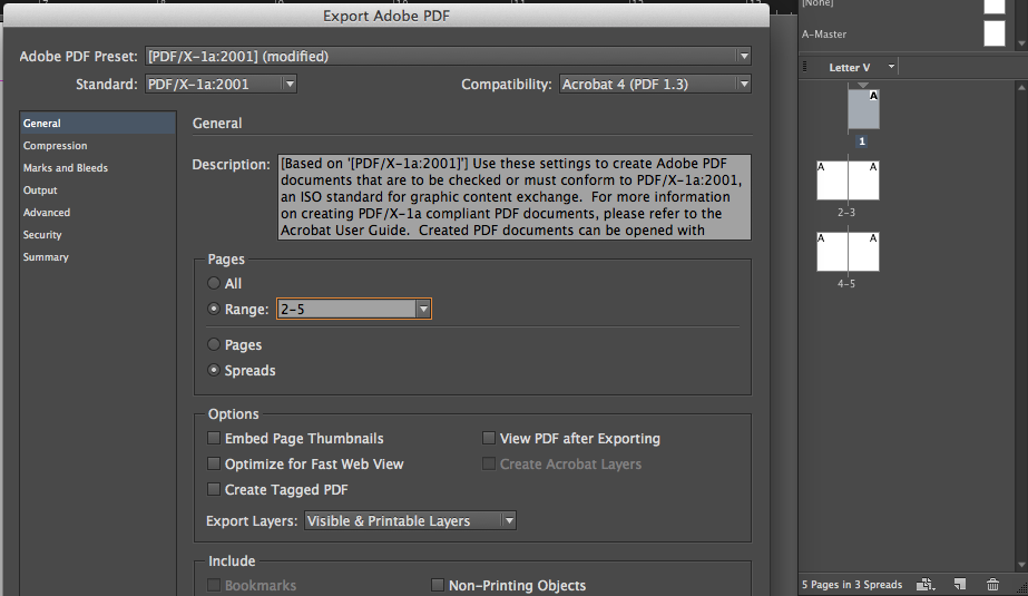

Some time back I figured this out and gosh I forgot how i did it.
because of lack of time here is one thing you can do to jump over this problem.
Leave page 1 empty.
design in page 2-3 & 4-5.
when you print just print from 2-5, skipping 1.
Also you can export your document as a PDF with spreads, but only pages 2-5.
You'll get a PDF with two 11x17

Add a new page to the page 4 level and ignore page one. If you've already created the 4 page document you could export it as a PDF, use the Extract Pages option in Acrobat and place the new PDFs as a single page to get the 4-1, 2-3 you need to print the file.

Yea a little different. I get bombarded with projects through out the day sometimes I have to find alternative solutions on the fly.
But look, Peter Spier got it.
I know I set the document with 5 pages (8.5x11 each), you just have to ignore page 1.
Turn Off Allow Document Shuffling and delete page 1.
1
2-3
4-5
will become
1-2
4-5
and then shuffle them as you wish.
now, this is a solution because your printing a simple 2 sided sheet of paper.
Copy link to clipboard
Copied
You can also turn off Page Shuffling in the Pages panel flyout menu and simply drag page 4 next to page 1, then print or export as spreads for a 4-page file.
