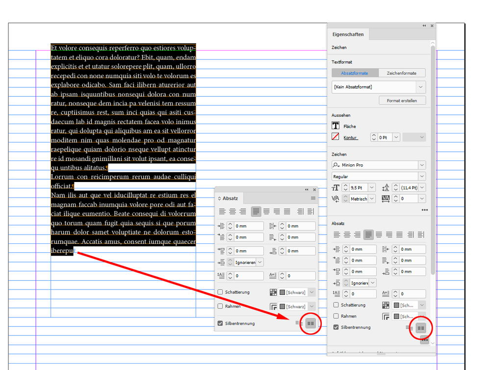

Hi COGordonW,
as Peter Kahrel already mentioned, Align to Grid is a paragraph formatting feature.
If no* paragraph style is used, select the paragraphs that you do not want to align and turn off the feature from the Paragraph Panel. This feature is also available from the Properties panel ( InDesign CC 2019 and above ).
From my German InDesign CC 2019 Paragraph Panel ( Absatz ) and Properties Panel ( Eigenschaften ) showing where Align to Grid is enabled:
Disabled:
Uwe Laubender
( ACP )
* [Basic Paragraph Style] is overridden or [No Paragraph Style] is overridden.

Thank you for sharing. I could not figure this out until I saw your generous screenshots.
