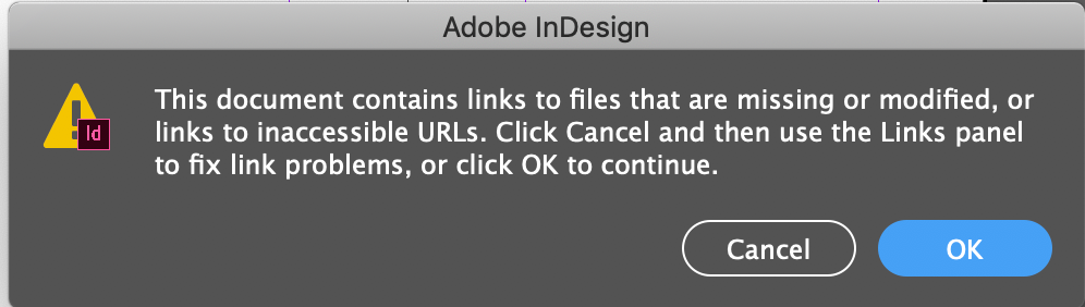

Can't export with broken links.Can't export with broken links.
When I go to export to print PDF, I receive the above error.

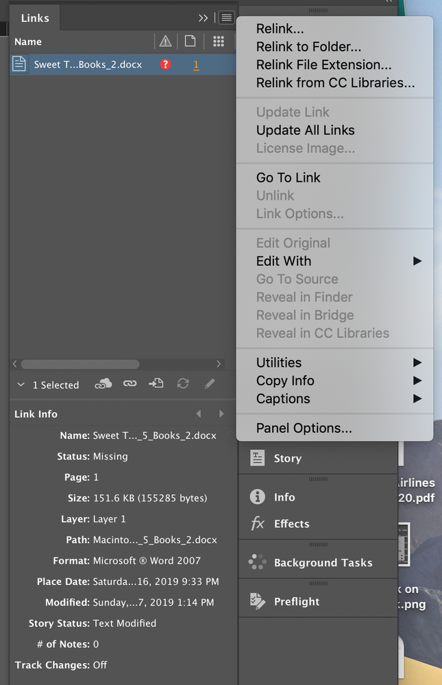

So, I click on the broken linked Word doc, then click on the flyout menu, and you'll see that Unlink and Link options are grayed out.
Click on the 3-hashes for the flyout menuClick on the 3-hashes for the flyout menu

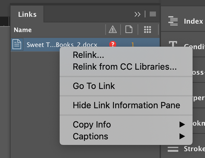

And if I just right-click on the doc, I receive the following popup menu. No help there.
Right click on broken linkRight click on broken link

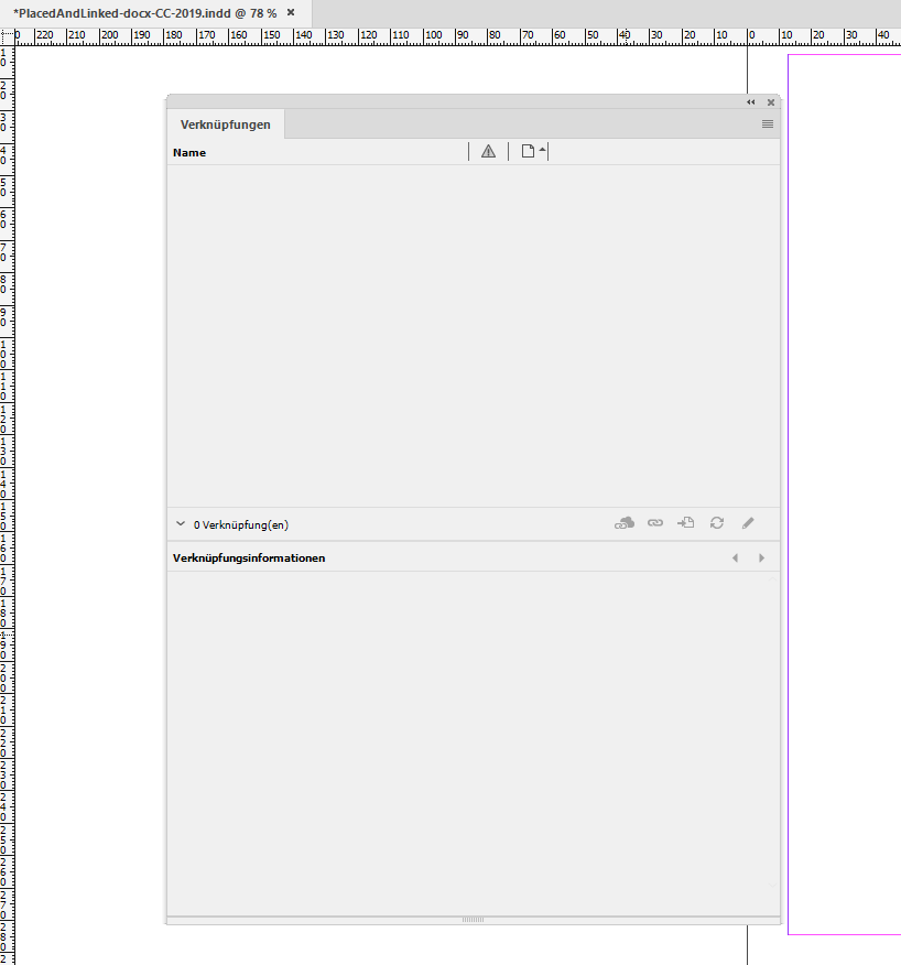

My screenshot from my German InDesign CC 2019 on Windows 10 is showing the command "Verknüpfung aufheben" ( Unlink ) not grayed out. And yes, I can unlink the linked docx file:
Unlinked:
