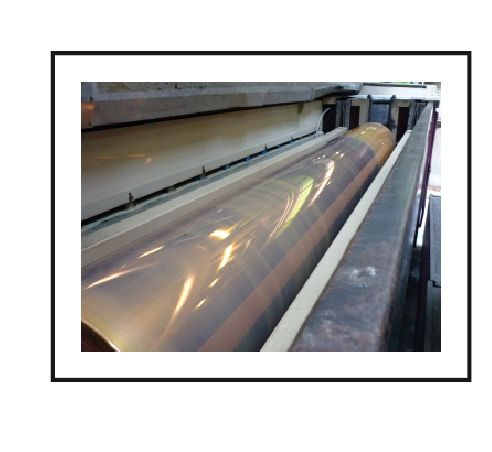

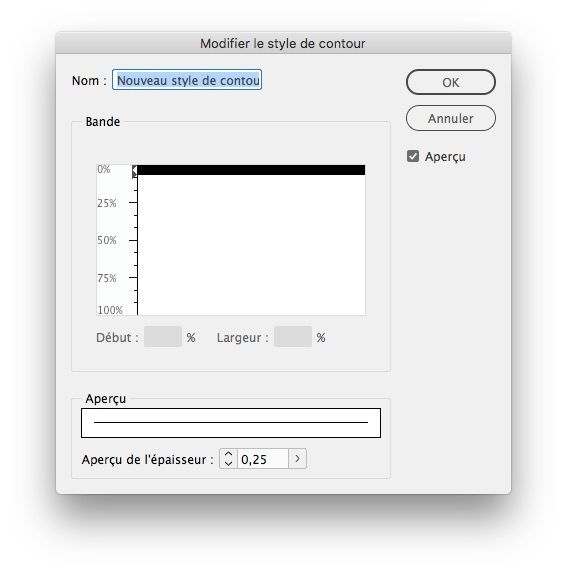

Make the picture frame bigger than the content, apply “paper” for the fill color and apply a black stroke. Center the content in the frame.

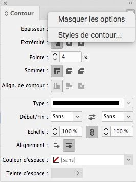

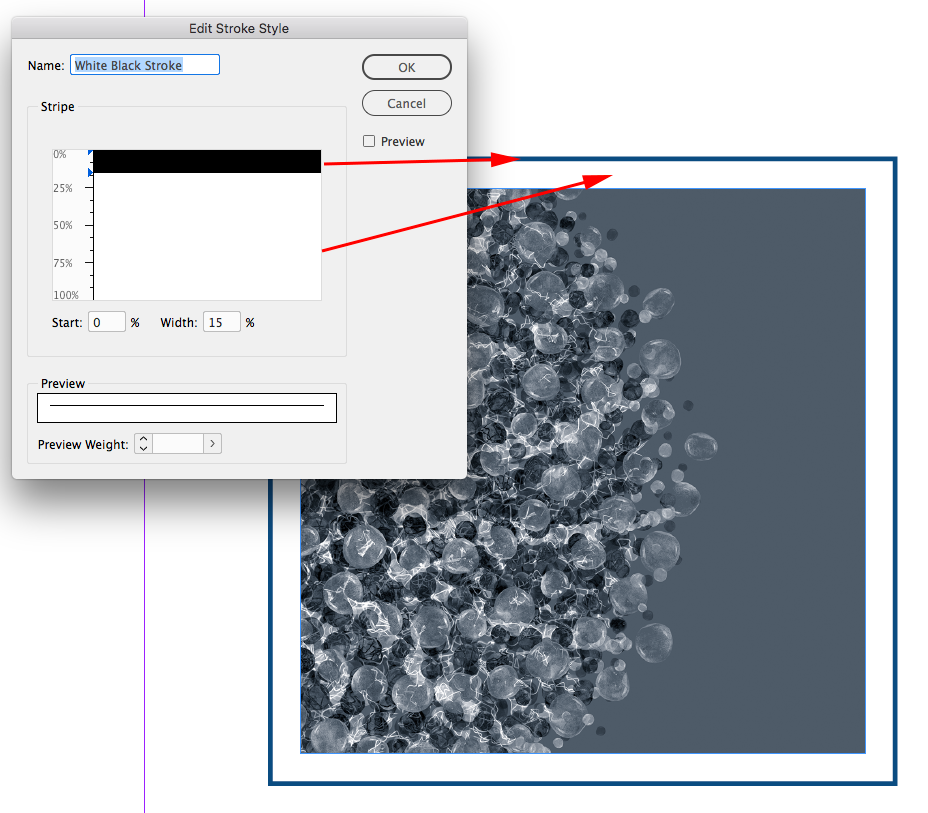

You can also create a custom stroke like this:
Capture d’écran 2020-07-06 à 18.59.22.jpgCapture d’écran 2020-07-06 à 19.02.33.jpgCapture d’écran 2020-07-06 à 19.03.55.jpg
The stroke has to be very thick: in the exemple above, the stroke is 57 pt

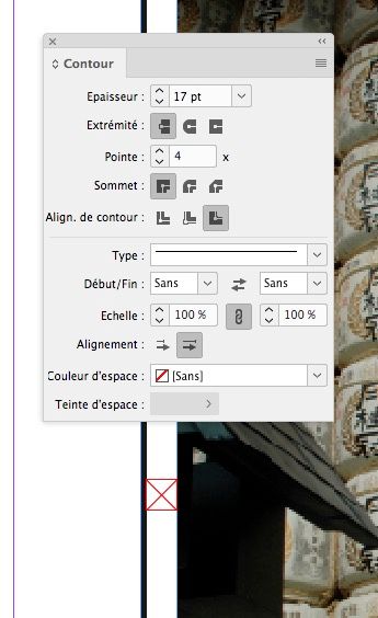

No time consuming and no need to draw any frame. Just place your pictures: as I explained in my first answer, create a custom stroke style with similar settings as mine (you'll have to make some tries depending the thickness of the black outline you want). Apply this custom stroke to any frame and you'll get the result you want to achieve. In my exemple below, the stroke is 17 pt thick (1pt is equal to 0,352 mm). If you want to be more efficient, follow the method Derek described (object style and keyboard shortcut).
In the screen capture, the red square measures 5 mm

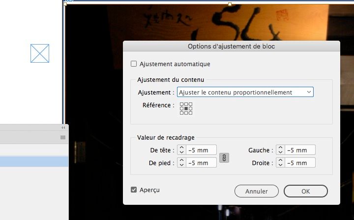

The easiest solution to this, IMO would be to set a negative crop in the frame fitting options, add the stroke and create the object style that way.
Aug 07, 2020 Aug 07, 2020
Hi Bob,
That was my first thought, but impossible to get equal insets without getting uneven image scaling. And worse, it does not honor the 5 mm asked for negative crop.

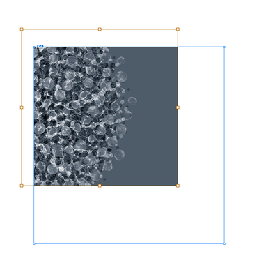

I am surprised that I can;t just extend the edges of the photo in white as you can in Photoshop.

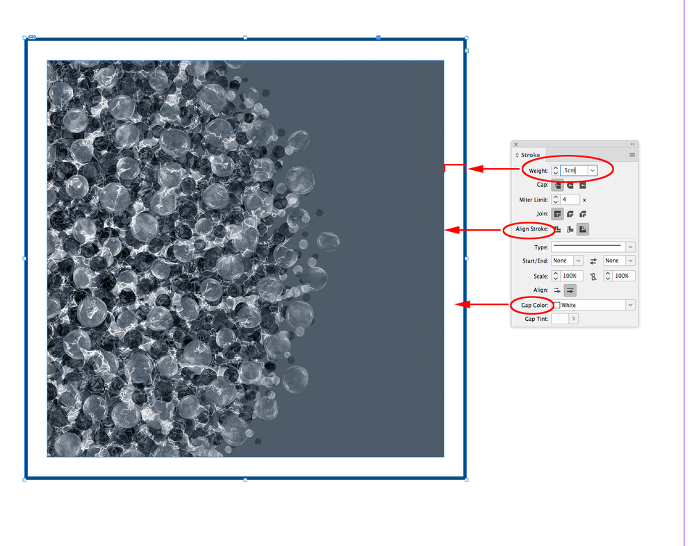

Before getting into the custom stroke style it might be worth noting that in InDesign every placed image has two parts—the image itself and a parent frame. The stroke gets applied to the parent frame, not the image.
Here the image (red frame) and its parent (blue frame) are not aligned
I can fit the parent frame to the image via Object>Fitting>Fit Frame to Content and then apply a custom stroke to the parent frame—select the parent frame with the black Selection tool, and the image with the white Direct Selection tool.
Below I’ve applied the custom stroke @jmlevy described. The stroke’s weight is .5cm, which includes the gap and stroke defined by the custom stroke style, the alignment is to the outside of the parent frame, and the Gap Color is defined as White. To create the custom style choose Stroke Styles... from the Stroke panel, then New>Type Stripe.
I can select multiple images and applied the custom stroke to all:
