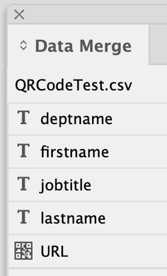

I am having an issue creating QR codes from URLs in a csv file.
In the original csv file, I added URL: to each URL, and the column name is #URL; but although I am getting the little QR code symbol in the data merge window, it will not generate a QR code when I run the merge. Each URL does work when I manually copy and paste each one into InDesign, so it's not the URLs themselves . . .

InDesign is recognizing that I have QR codes in my cvs file (see the screen shot in my original post)— however, InDesign is not generating the QR codes when I run the data merge.
Just wondered if anyone else had this same issue.

Well, with my feeble DM skills, I just made it work without any problems — first, last, phone, URL code. Did nothing but create a simple CSV file and set up the merge.
Is the problem that your import is not reading the URL data correctly? Or at all? Or that the code does not read back correctly? Or... what?
Since your merge list looks okay (and you know how to designate a QR code field), it's got to be a data content/format issue.
