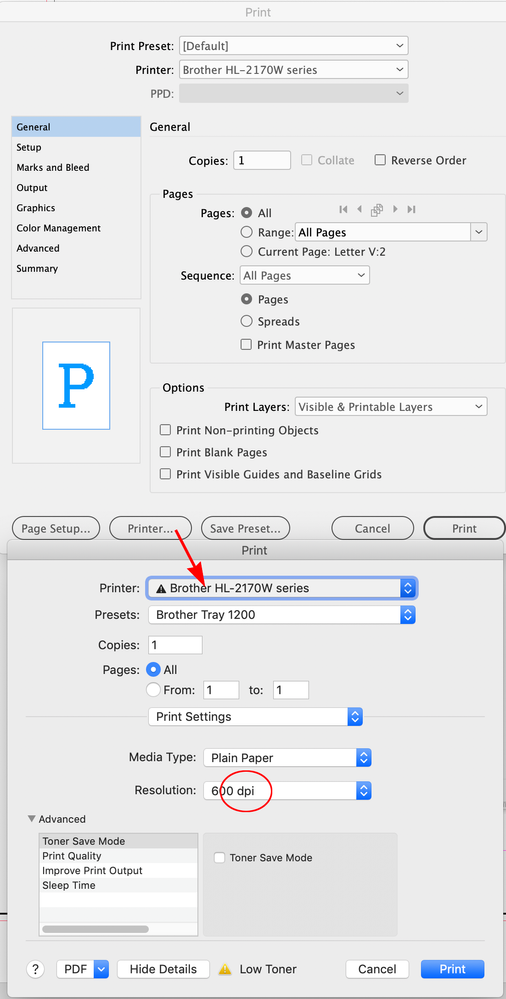

DPI is the print device resolution, which is set by the printer driver not InDesign.
As Peter suggests most print devices convert a continuous tone image into either a halftone screen, which has a resolution referred to as Lines Per Inch (LPI), or a stochastic screen.
The halftone screen dots are drawn with the smaller printer dots, and the illusion of tonality is created by modulating the size of the halftone dot. A platemaker outputting at 2400 dpi can accurately draw a 150 line halftone screen, my 1200 DPI laser printer can draw a 90 LPI halftone screen.

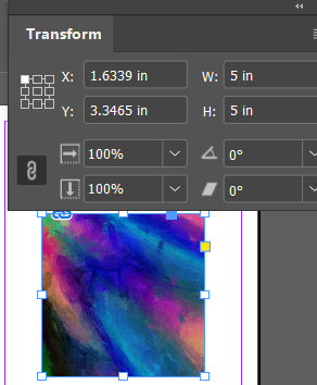

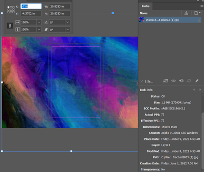

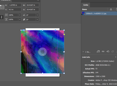

Same was as you can
If it's 1500 x 1500 @ 72ppi
You place that at 100% then it's 1500 x 1500 with 72 pixels per inch
Your size is 1500/72 = 20.83inches
If you place it at 50%
And it's half the size
And double the resolution
A 72PPI image placed at 24% will yield 300PPI
If you wanted to know what that size is before placing.
Original size is 1500 x 1500
so it's 1500/300
= 5 inches
That's it - basic division of the Pixels by the resolution.

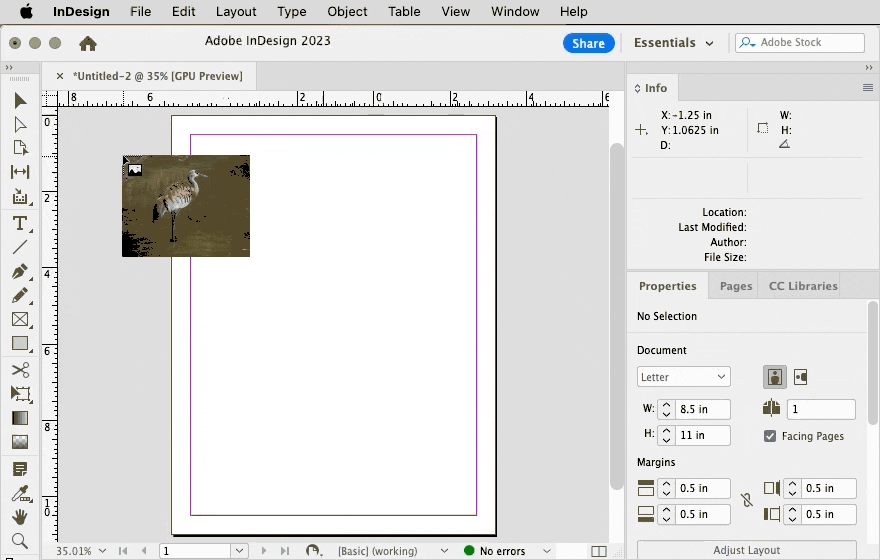

Some definitions (some of which are already discussed):
Example: You need a 300 ppi print of an image. Just saying 300 ppi actually isn’t enough information, because per the definition above, to get to PPI you need to know both the pixel dimensions and final physical size (inches/cm) of the print. If you say the physical dimension needs to be 10 inches wide, adding that value resolves it: To achieve 10 inches wide at 300 ppi, the image must be 3000 pixels wide (10 inches times 300 ppi). Of course you can use Photoshop Image Size to work that out.
Suppose the printer is a commercial digital printer or platesetter with a hardware device resolution of 2400 dpi. That means you will print a 300 ppi image on a 2400 dpi printer. The image doesn’t have to be 2400 dpi, because those dots are used to build the screening pattern that renders image tones and colors. (Type and vector graphics do render at device dpi.)
If it was a halftone printing process, then you could have three numbers — which are all true for the same image: A 300 ppi image, printed on a 2400 dpi device, using a 150 lpi halftone screen (150 lpi halftone dots built using the smaller 2400 dpi device hardware dots).
But the ppi resolution of an image changes if you resize it on a print layout. If you halve the physical length on the layout (without cropping), the image ppi must double. So a 3000 px wide image prints at 300 ppi at 10 inches, and also at 150 ppi when 20 inches wide, and at 600 ppi when 5 inches wide. The ppi resolution after final scaling is the Effective PPI resolution. Photoshop shows you this in Image Size (if Resample is disabled), but Photoshop doesn’t know if the image will be resized in another application later, changing the Effective PPI again.
Fortunately, the Info panel in InDesign can show you Effective PPI interactively — see the demo below. And of course Effective PPI is not InDesign-specific. This is how image ppi is calculated for print in any print layout application by any company. Because you can’t get around the math: Final image ppi for print is always the pixel dimensions divided by the physical dimensions times the scale percentage (how much it’s resized) on the layout.
In the demo below, a 3000 × 2400 pixel image is placed into InDesign. Because Photoshop embedded a ppi value of 300 in the image metadata, InDesign reads that, divides the pixel dimensions by the metadata ppi, it works out to 10 inches wide, and the Info panel reports 300 ppi as the Effective PPI. But as you resize the image, InDesign recalculates the ppi based on the new physical dimensions, updating the Effective PPI. That’s how InDesign calculates resolution.
And again, dpi does not enter into this until the job hits the printer. At that time, the printer renders the job at the dpi of the hardware.

Indeed @Conrad_C
Thanks for the video - more or less the same demonstration I have given in screenshots above.
