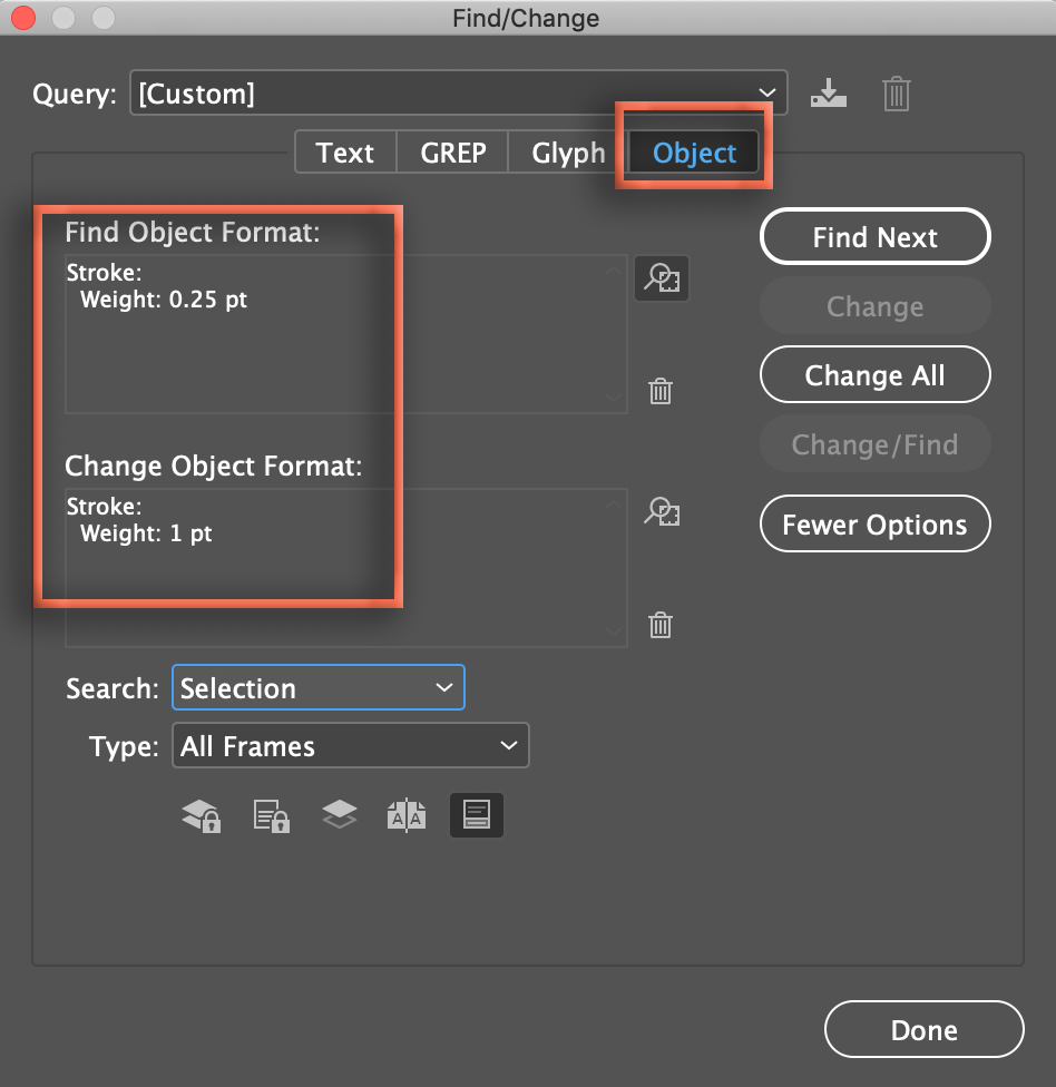

For others reading this thread who just want to update one variation—and not a range of variations—you can use an Object Find/Change.
~Barb
