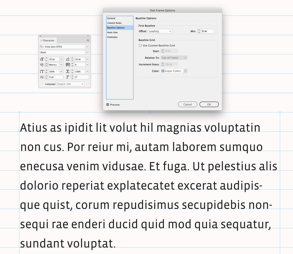

Hi @Bedazzled532 , Your text frames’ Use Custom Baseline Grid setting is interfering with the Rule Above technique. You could simplify the document by using Primary Text Frames on the Parent Spread with the fill and stroke applied to the Primary Frames rather than creating extra frames for the borders. See attached.
I’m using a document Baseline Grid set up in Preferences like this:
On the Parent Spread there are Primary Text Frames with their Text Frame Options  setup like this:
Now Rule Above for your Header style works and everything is aligning to the grid:

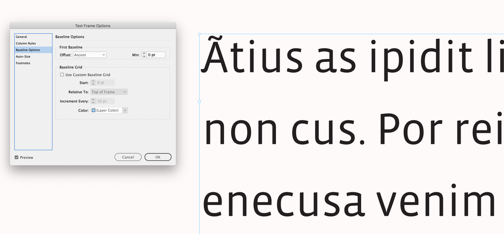

Since you are using a fixed baseine grid, I see no need to define your text frame with a first baseline to Fixed. Change it to Ascent, then all of the other suggestions will work. I personally uses the same technique that @rob day uses.
Here's MY fixed file:

I never use the Fixed Offset, but it does make sense that it would not work with a Rule Above spacer. Fixed Offset with Min set to 0 puts the baseline aligned with top of the text frame:
If I add a Rule Above with no Offset the rule aligns with the baseline, so it starts outside of the text frame, and Keep In Frame has no affect:
A Leading Offset gets you where you want to be with or without Align to baseline grid turned on:

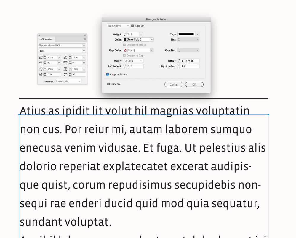

InDesign is aggressive about suppressing space above a paragraph at page tops, and there is no simple way to force it to retain the space. The one and only reliable workaround is to use a Rule Above —
  • For the paragraph you want to have page-top spacing, go to the Paragraph Style menu, Paragraph Rules pane.
  • Check to enable Rule Above.
  • Set the rule width to zero, and the color to None.
  • Check "Keep in Frame." (Very important, none of this will work without this setting!)
  • Set the Offset to the amount of space-above you want.
A kind of wonky method, but it's the only way to retain space above at page tops.
This should work regardless of baseline settings, although the spacing will snap to the nearest baseline unless you disable that snap in the paragraph style. If you're having trouble, I'd bet you didn't check Keep in Frame. It's a somewhat cryptic name and easy to to overlook.

The good news is: it's not you. The maybe-bad news is: I've never seen this behavior before.
You're on the right track: it has to do with the First Baseline mode. Set it to Fixed, and the rule-above spacing no longer works. It works fine with every other setting of that element.
I have no idea why this is happening, but then, I can't remember ever using a Fixed value for the first baseline. If you can choose any of the others, you can keep all your other text frame settings and have the heading space down as desired.
Note that setting a style to align to baseline seems to completely override both the First Baseline type and value settings — so they are doing nothing in your layout except that choosing Fixed is interfering with the spacing hack.
