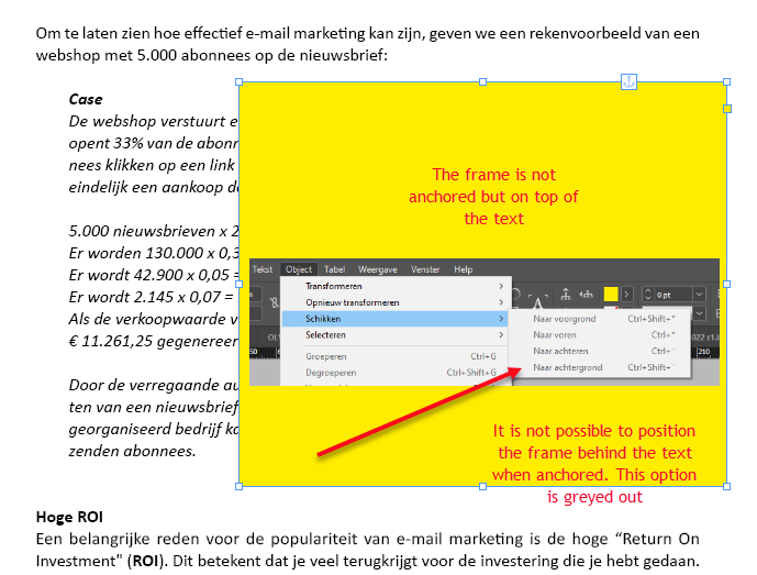

I want to emphazise a part of the text in a text box by placing a frame behind the text and add color to the frame. This works fine but when I anchor the frame, it frame be positioned on top of the text and I am not able to move it behind the text. How can I solve this? See screenshots.

In your case, you could set the yellow anchored object to overprint (Window> Output> Attributes> overprint fill), this should work fine for print, but not necessarily for screen viewing of the PDF, as some viewers will ignore overprinting.
Other options would be to send the yellow box behind the text and group it with the text box, or apply a yellow drop shadow to the anchored object, color the object white, and move it out of the text box, offsetting the shadow to position it where it is needed. Or applying a paragraph style.

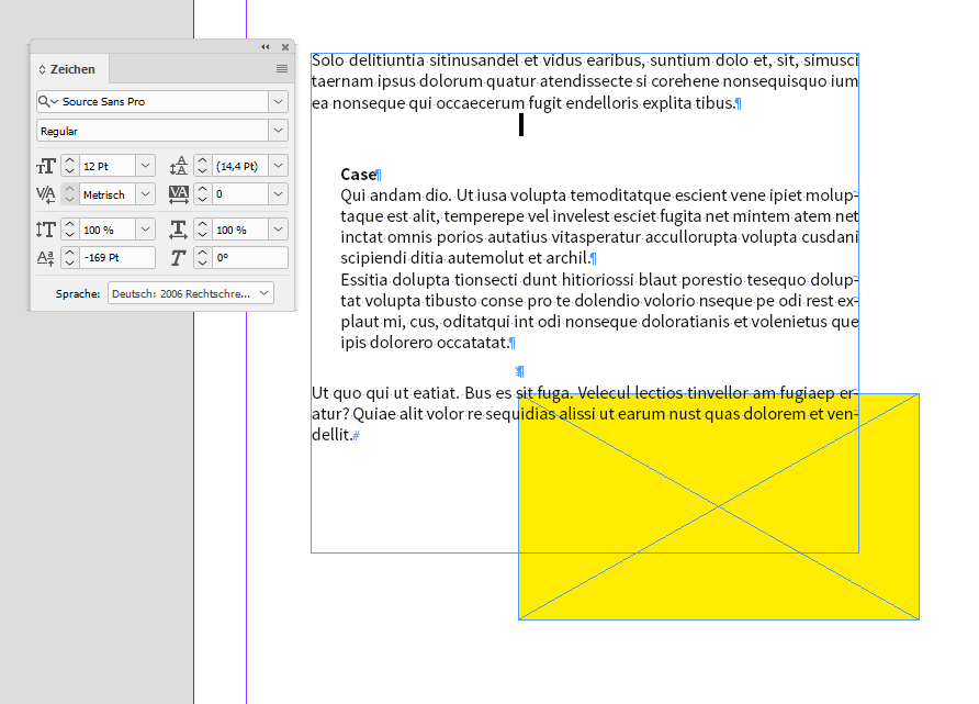

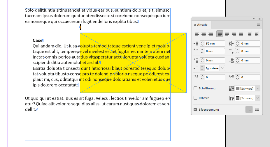

Use an Above Line Anchored object in its own paragraph above the paragraph starting with "Case".
To get the right starting point horizontally use a high indent value for the paragraph. Just like that:
EDIT: In my sample above I used a 50 mm indent for the paragraph with the anchor character. So here added another screenshot that is showing the paragraph character selected and the Paragraph panel. Also a new annotation regarding the Alignment option of the Anchored Object dialog:
In the Anchored Object dialog you have to use the alignement option (Text Alignment), in my German screenshots (Textausrichtung), so that the anchored object will follow the value for the indented paragraph.
Note 1: The negative value that pushes the anchored rectangle down and will also render it in stacking order behind the text cannot exceed the height of the anchored object.
Note 2: That limit, the height of the anchored object, can easily be pushed by applying a high negative value of baseline shift to the anchor special character:

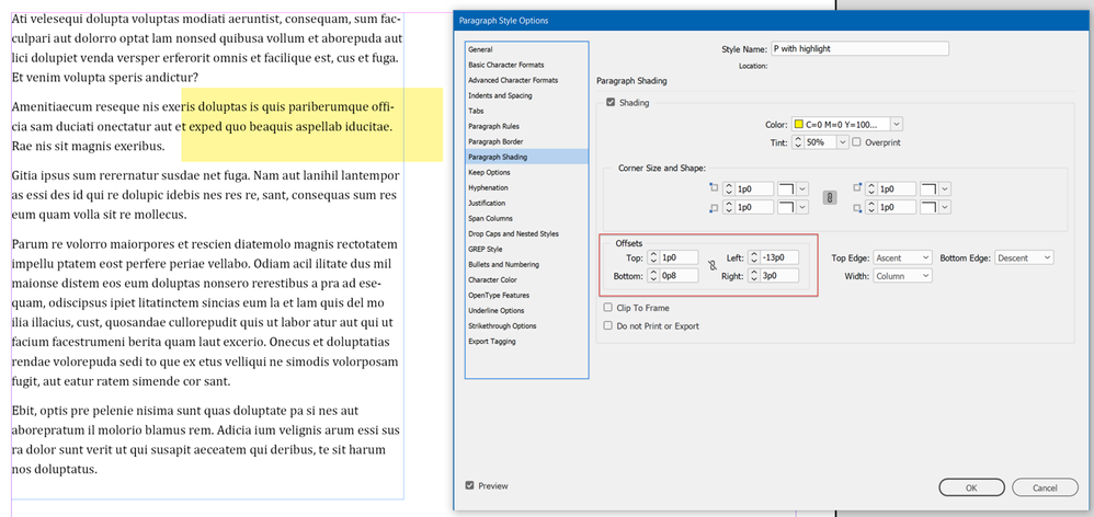

And here's a sample of using Paragraph Shading.
Adjust the yellow "faux box" size and position by adjusting the Offsets.
The shading can extend beyond the frame, beyond the paragraph into neighboring paragraphs, or be behind only part of the paragraph. Endless visual designs with this powerful trick. And very simple to do.
