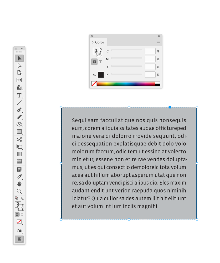

Hi @Michael J B , If you Direct Select (white selection tool) the side of a frame, you can Copy, then Paste in Place to effectively clone the frame’s edges (see @Scott Falkner ’s reply). Give the clones a stroke, and Group the clones and frame:
Copy>Paste in Place>Select All>Group

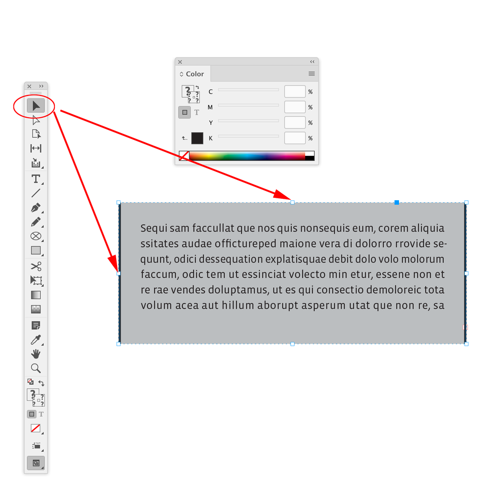

Now using the Selection tool the frame can be resized and the side strokes will travel with the frame:
Oct 02, 2023 Oct 02, 2023

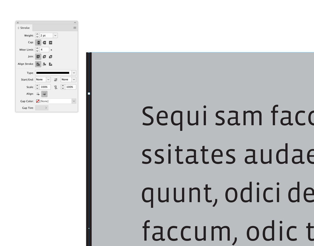

I’m aligning my stroke to the inside:
Ah... overlooked that. One nit squashed. 🙂
