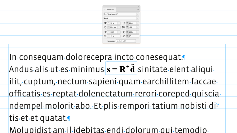

You can add tracking before and after the equation. Should be easy to add to the script, but you can do it in the interface as well with two GREP queries:
Find what: .(?=~a)
Change to: <Leave empty>
Change format: some negative tracking
Find what: ~a\K.
Mar 11, 2024 Mar 11, 2024
That one is unnecessarily complicated. One query will do it, it applies tracking to any character  followed by an inline followed by any character. It also works at the end of a paragraph:
Find what: .~a

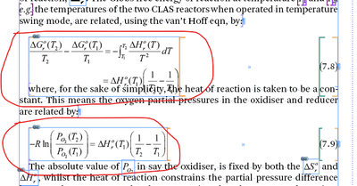

After the script was executed, below the display equations merged into the paragraph lines. I need two pica of visual space for the display equations below only.  Inline questions no issues.
Display equations are controlled by the paragraph styles:
EQ, EQ-f, EQ-m, EQ-l
My requirement:
Thanks

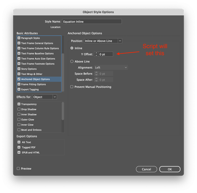

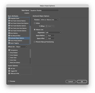

Hi @kanagakumar, I have updated the script above to try to handle "display" equations, assuming—for now—that these are equations that follow a carriage return or forced line break character.
You should make an Object Style for each type of equation, that at least has the Anchored Object Settings. These are what I suggest:
Do you see where is says 2pt space after? You can change that to your needs.
Let me know if I have guessed correctly and that it works the way you want.
- Mark

Dear Mark,
Yes, Correct. Your script adjusts the points in the anchor object panel.
Now i fixed the overlapping issue using in the object style "Text Wrap" option. And i will apply manaully this object style name  for each display equations.
Before style applied:
After style applied (object style name -- "Eq-text Wrap"):
Only the paragraph styles "EQ" and "EQ-l" will require this object style to be applied; No need to be applied globally. All of the issues have been resolved if this script add an object style name. Is it possible to apply this object style name to this script based on paragraph style name "EQ" and "EQ-l"?
