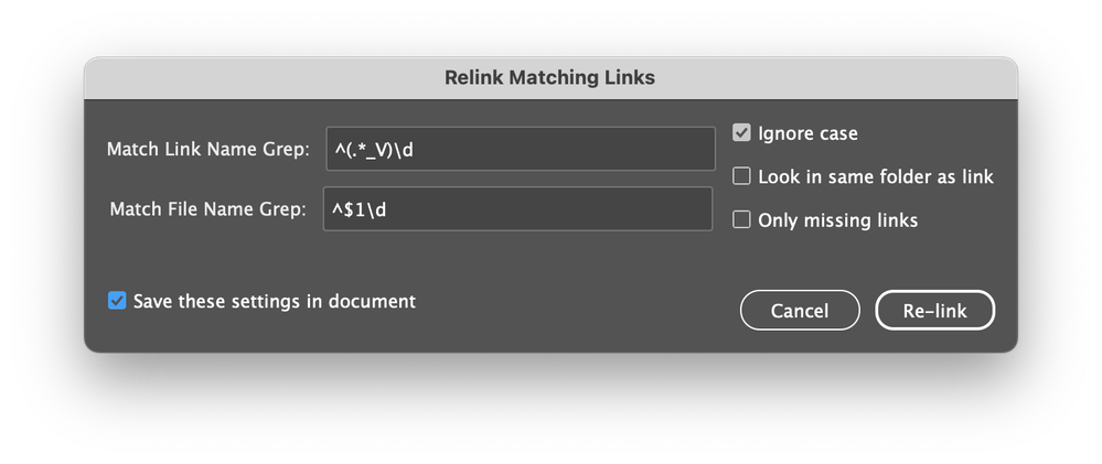

UPDATE: I've added a UI, with the option to save the settings in the document. This will make it easier to use I hope.
Here's a visualisation of the matching process, showing that both link name and file name must be matched:
Here's the script:

function main() {
    var settings = {
        doc: app.activeDocument,
         * (A) linkMatcher - regex to match a LINK NAME
         * In this example, we match any link whose name includes
         * _V with a digit after it, and we capture the name and
         * the _V for matching the file later in (B).
        linkMatcher: /^(.*_V)\d/i,
         * (B) fileMatcher - string to match a FILE NAME
         * In this example, we match a filename starting with
         * the contents of capture group 1 from (A) and a digit
         * (backslash must be escaped in a string).
        fileMatcher: '^$1\\d',
         * whether to search for links in the current link's folder
         * if this is false, will ask user to select folder
        lookInSameFolder: false,
         * whether to only update only matched links that are MISSING
         * if this is false, will attempt to match *all* links
        onlyMissingLinks: false,
        // whether to show results after running script
        showResults: true,
        // whether to show the UI
        showUI: true,
    if (settings.showUI) {
        var result = ui(settings);
        if (2 === result)
            // user cancelled
            return;
        if (undefined != settings.cleanup) {
            settings.cleanup();
            delete settings.cleanup;
    // do the relinking
    relinkByMatchingLinkAndFile(settings);
app.doScript(main, ScriptLanguage.JAVASCRIPT, undefined, UndoModes.ENTIRE_SCRIPT, "Relink Matching Links");

function ui(settings) {
    var key = 'relinkMatchingLinks',
        savedValues = settings.doc.extractLabel(key).split('\n'),
        // controls
        w = new Window("dialog { text:'Relink Matching Links' }"),
        columns = w.add("group {orientation:'row', margins:[0,0,0,0] }"),
        leftColumn = columns.add("group {orientation:'column', margins:[0,0,0,0] }"),
        matchLinkGroup = leftColumn.add("group {orientation:'row', margins:[0,0,0,0] }"),
        matchLinkLabel = matchLinkGroup.add('statictext', undefined, 'Match Link Name Grep:'),
        matchLinkField = matchLinkGroup.add('edittext {preferredSize: [260,30]}'),
        matchFileGroup = leftColumn.add("group {orientation:'row', margins:[0,0,0,0] }"),
        matchFileLabel = matchFileGroup.add('statictext', undefined, 'Match File Name Grep:'),
        matchFileField = matchFileGroup.add('edittext {preferredSize: [260,30]}'),
        rightColumn = columns.add("group {orientation:'column', margins:[0,0,0,0] }"),
        sideControls = rightColumn.add("group {orientation:'column', alignChildren: ['left','top'] alignment:['fill','top'] }"),
        ignoreCaseCheckBox = sideControls.add("CheckBox { text: 'Ignore case' }"),
        lookInSameFolderCheckBox = sideControls.add("CheckBox { text: 'Look in same folder as link' }"),
        onlyMissingLinksCheckBox = sideControls.add("CheckBox { text: 'Only missing links' }"),
        bottomUI = w.add("group {orientation:'row', alignment:['fill','top'], margins: [0,20,0,0] }"),
        extraControls = bottomUI.add("group {orientation:'column', alignChildren: ['left','top'] alignment:['fill','top'] }"),
        saveInDocCheckBox = extraControls.add("CheckBox { text: 'Save these settings in document' }"),
        buttons = bottomUI.add("group {orientation:'row', alignment:['right','top'], alignChildren:'right' }"),
        cancelButton = buttons.add('button', undefined, 'Cancel', { name: 'cancel' }),
        relinkButton = buttons.add('button', undefined, 'Re-link', { name: 'ok' });
    // event handling
    relinkButton.onClick = relinkButtonClicked;
    if (savedValues.length > 1) {
        saveInDocCheckBox.value = true;
        matchLinkField.text = regexSource(savedValues[0]);
        matchFileField.text = savedValues[1];
        ignoreCaseCheckBox.value = 1 === Number(savedValues[2]);
        lookInSameFolderCheckBox.value = 1 === Number(savedValues[3]);
        onlyMissingLinksCheckBox.value = 1 === Number(savedValues[4]);
    else {
        saveInDocCheckBox.value = false;
        matchLinkField.text = settings.linkMatcher.source;
        matchFileField.text = settings.fileMatcher;
        ignoreCaseCheckBox.value = settings.linkMatcher.ignoreCase;
        lookInSameFolderCheckBox.value = settings.lookInSameFolder;
    w.center();
    return w.show();

Edit 2024-01-17: fixed bug triggered when cancelling folder select dialog.
Edit 2024-01-18: added better result alert to show how many links were matched as well as how many links were re-linked. Also adjusted example configuration because some of lukes files use a lowercase _v.
Edit 2024-01-18: added optional UI, tweaked some of the variable names to make more sense.

Duuuudeeee this looks amazing! and thank you soooooo much for taking it on!
I loaded and ran it but it didnt give me the option to select a folder to get the new links to and then it just popped up with 'done - relinked 0 of 16 images'
Which would make sense if it didnt have anywhere to get them from i guess...
Let me know if you need anything else from me - i will owe you a drink if this works!
Jan 17, 2024 Jan 17, 2024
Very strange that it didn't ask you for a folder. Just checking that you still have this line in the params area?
 * whether to ask user to choose the target folder; switch this
 * to false if the new links are in the same folder as the old
true,
If so, I honestly cannot understand why that didn't ask you. Can you try the following script on its own?
var folder = Folder.selectDialog();
if (folder) alert('success!');
If all goes well it will ask you to select a folder and, if you don't cancel, will alert "success". Let me know what happens.
This is same command is performed on line 371 of my script. Can you check that line 371 looks okay on your text file, in case something happened during the copy/paste.
- Mark
I also fixed a small bug in the code above. I don't think it will help your problem, but you should update your script with the new code. - Mark
Community Beginner ,
V strange - the open folder only, worked but same situation for the re pasted full script - I have DMd you a test file if thats helpful
Thank youuu
Hi @Luke29383164kjl6, I've had a look at your demo files and discovered two things:
(1) it wasn't really a fault with the code, but just wasn't configured right for you. In your original post you had _V1 (capital V) and my example Regex matched capital V. I've changed it to be case insensitive so it'll match either _v or _V, and
(2) it *was* a fault with the code... that it didn't make it clear to the user what the problem was. I've had a go at fixing this by changing the result alert message to include the number of *matched* links. If this was present when you tested it the first time you would at least have known that not only did it not relink 16 links, but it *matched* zero links, and therefore the problem may have been the linkMatcher variable.
I'll update the code listing above, and you can try again.
- Mark
This is incredible!   Thank you soooo much dude!
