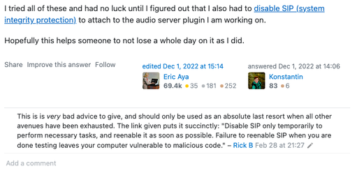

Participant , Jun 08, 2023 Jun 08, 2023
I've found the solution here but this method is NOT raccomanded.
Disabling the sip everything works correctly, but it is NOT a recommended practice at all.
If you disable SIP, it opens up the possibility of making changes to the operating system, including accessing and modifying sensitive system files. However, there are various negative aspects to consider:
  1. Compromised security: Disabling SIP makes the operating system more vulnerable to malware attacks and unauthorized modifications. Since SIP p

Participant ,
  1. Compromised security: Disabling SIP makes the operating system more vulnerable to malware attacks and unauthorized modifications. Since SIP provides significant protection, disabling it can expose the system to greater risks.
  2. System instability: Making changes to the operating system can result in system instability. Even a small incorrect modification can cause booting issues, frequent errors, or even system crashes.
  3. Operating system updates: Some macOS system updates require SIP to be enabled in order to be installed correctly. If SIP is disabled, you may need to temporarily re-enable it to apply security updates.
  4. Untrusted applications: By disabling SIP, you open up the possibility of installing and using untrusted or potentially harmful applications that could compromise the system or personal data
So pay close attention to disable the SIP.
