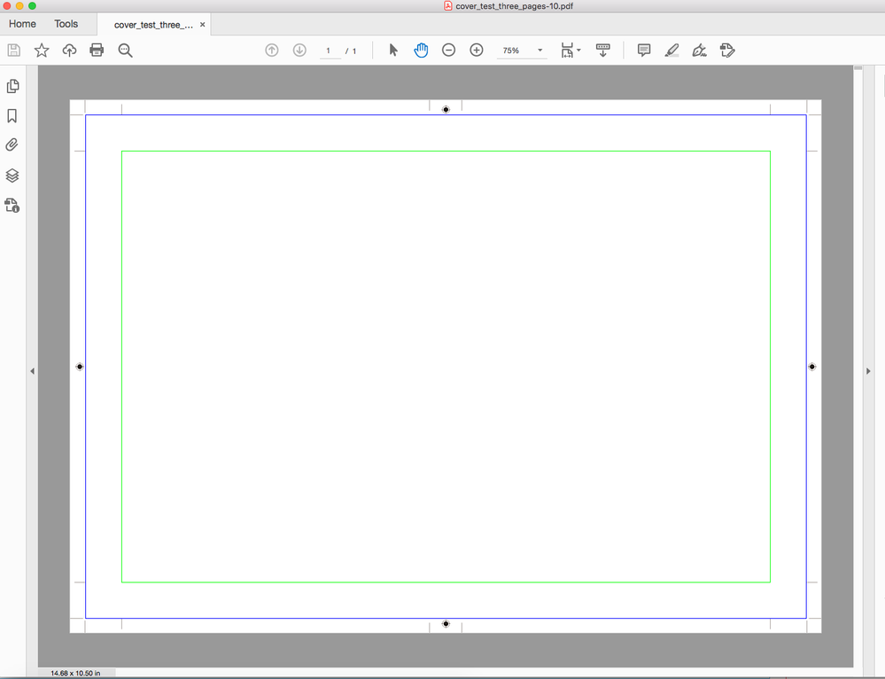

Update: I need it to look like the following image, but the cover (front/spine/back) should be centred (just like it is when I export anything from InDesign). Look at the crop marks, fold marks, etc---they are all outside the cover. I have looked at the INDD file they have created this image from, but they used regular lines to insert those marks, which is not what I want, because that is so imprecise.

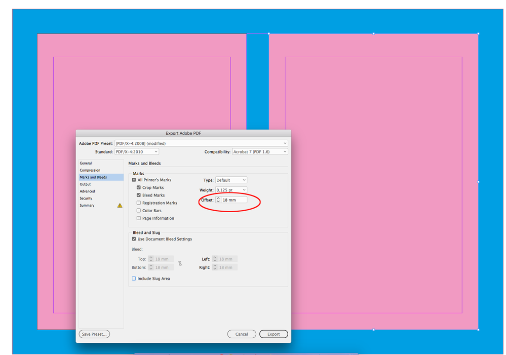

If you don’t want to build the "bleed" into the document as I suggested in the other thread then you can set the Offset of the crop marks to equal the bleed, and match the printer’s template:
In this case the "crop" marks indicate folds not cuts—the printer isn’t going to actually trim the page at the crop marks.

Here’s your attached file exported with an 18mm Offset:

I find this one a bit weird. Who ever did this, he/she switched width and height values when going from inches to millimeters. So yes, it's confusing. Width of pages is clear, width of spine is clear, but one has to calculate the outside bleed for example. FWIW: 23 inches is not 584 mm as suggested in the left lower corner.
If this screenshot is from a PDF the only sane thing you could do is to exactly build on it where the inner marks showing is the area of your page, the outer edge of the blue area is your bleed area and the whole thing should fit exactly to your slug area.

Thank you all for your time and that you tried to help me. Actually the marks offset was what I was looking for, however, I did not notice it in the export settings yet. Thank you @rob_day!
