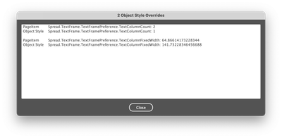

And one last addition, for anyone who is interested. I've made huge improvements under the hood, including quite good xml parsing (thanks to Peter Sirka's nifty little function—see script comments) and displays the differences with much better context. The underlying function listDifferences(items,options) can now handle two or more files, and the formatting is separated.
- Mark
 * Shows object style override differences
 * for the selected page item.
 *  m1b
 *  2022-07-18
 * @discussion https://community.adobe.com/t5/indesign-discussions/how-to-find-whether-my-textframe-have-overriddenobjectstyle-or-not-in-my-document-using-javascript/m-p/13071120
 * Important note:
 * This is more strict than Indesign's own
 * object-style-overridden criteria, so
 * sometimes an object may show differences
 * while not showing the (+) symbol in the
 * Object Style panel.
function main() {

 * Determines if item has ObjectStyle overrides
 * and displays a list of the overriden properties.
 *  m1b
 *  2022-07-18
 * Note: this function is MORE STRICT
 * than Indesign's normal determination
 * of overridden-ness.
 *  {PageItem} item - an Indesign page item.
 *  {Boolean} - if true, then object has overrides.
function showObjectStyleOverrides(item) {
    if (
        item == undefined
        || !item.isValid
        || typeof item.exportFile !== 'function'
        return;
    // make a duplicate item
    dup = item.duplicate();
    var itemSnippet = saveSnippet(dup, 'item.xml');
    // with no objectStyle overrides
    dup.clearObjectStyleOverrides();
    // and make a snippet of that
    dupSnippet = saveSnippet(dup, 'dup.xml');
    // clean up
    dup.remove();
    // set up arguments for listDifferences
    var comparisons = [
        { label: 'PageItem', file: itemSnippet },
        { label: 'Object Style', file: dupSnippet }
    // in snippet XML, we don't care about these
    var options = { ignoreThese: /x:xmpmeta/ };
    // collect differences between the two
    var differences = listDifferences(comparisons, options);
    // display differences
    if (differences.length > 0)
        alerter(differences.length + ' Object Style Overrides', formatDifferences(differences), 1000, 500);
    else
        alert('This item has no Object Style overrides.');

Example 1: First I alt-click on the object style in the Object Style panel (to clear overrides) then I change the column number of the text box to 2 column (the object style is 1 column).

Hi @Karthik SG, I've made a variation of my script that does what you are asking I think. Here is example output:

            // add value, using label as key
            comparator[key][label] = value;
    // tidy up new keys
    var keys = uniquify(keys);
    // check if values are different
    // and add them to differences
    for (var k = 0; k < keys.length; k++) {
        var key = keys[k],
            isDifferent = false,
            // the value we check against
            currentValue = null,
            // will hold array for each object's line
            linesForKey = [];
        for (var o = 0; o < objs.length; o++) {
            var label = labels[o],
                v;
            // add label for this object
            if (
                comparator[key] === undefined
                || !comparator[key].hasOwnProperty(label)
                || comparator[key][label] == undefined
                || comparator[key][label] == 'undefined'
                v = empty;
            else
                v = comparator[key][label];
            // store this line in case we need it
            linesForKey.push([label, key, v]);
            // initialise current value
            if (currentValue === null)
                currentValue = v;
            // or check if values are different
            else if (currentValue !== v)
                isDifferent = true;
        if (isDifferent === true)
            differences.push(linesForKey);
    return differences;
 * Format the output of listDifferences function.
 * @param {Array} differences - listDifferences() output
function formatDifferences(differences) {
    var formatted = [],
        labelWidth = 0,
        // regex to tidy strings
        firstTwoElements = /^([^\.]+\.[^\.]+\.)/,
        linefeeds = /[\r\n]/g,
        emptyBrackets = /\[\]/g,
        tabs = /\t/g;
    // calculate label width
    for (var o = 0; o < differences[0].length; o++)
        if (labelWidth < differences[0][o][0].length)
            labelWidth = differences[0][o][0].length;
    for (var d = 0; d < differences.length; d++) {
        var linesForKey = [];
        for (var o = 0; o < differences[d].length; o++)
            linesForKey[o] = formatDifference.apply(null, differences[d][o]);
        formatted.push(linesForKey.join('\n'));
    return formatted.join('\n\n');
    // helper functions
    function formatDifference() { var a = arguments; return pad(a[0], labelWidth + 2) + '\t' + tidyKey(a[1]) + ': ' + tidyValue(a[2]) };
    function tidyKey(key) { return key.replace(firstTwoElements, '').replace(emptyBrackets, '') };
    function tidyValue(value) { return value.replace(linefeeds, '\\n').replace(tabs, '\\t') };
 * Convert a simple key/value object into
 * array of [[key, value], [key, value], ...]
 * if value is also an object, it will
 * recursively convert that also.
 * @param {String} key - the starting key
 * @param {String|Array|Object} obj - the starting value
 * @returns {Array} - [[key, value], [key, value], ...]
function expandLines(key, obj, i) {
    key = String(key);
    var lines = [];
    if (obj == undefined)
        lines.push([key, 'undefined']);
    else if (obj.constructor.name == 'String')
        lines.push([key, obj]);
    else if (obj.constructor.name == 'Array')
        for (var i = 0; i < obj.length; i++)
            lines = lines.concat(expandLines(key + '[' + i + ']', obj[i], i));
    else if (obj.constructor.name == 'Object')
        for (var k in obj)
            if (obj.hasOwnProperty(k))
                lines = lines.concat(expandLines(key + '.' + k, obj[k], i));
    return lines;
 * Reads a file contents.
 * @param {File} file - the file to read.
 * @returns {String}
function readFile(file) {
    if (
        file == undefined
        || !file.exists
        return;
    file.open('r');
    var text = file.read();
    file.close();
    return text;
 * Exports item as an Indesign snippet (XML) file.
 * @author m1b
 * @param {PageItem} item - an Indesign page item.
 * @param {String} name - the snippet file name (include extension).
function saveSnippet(item, name) {
    // put in temp folder
    var snippetFile = File(Folder.temp.fsName + '/' + name);
    // export as indesign snippet
    item.exportFile(ExportFormat.INDESIGN_SNIPPET, snippetFile, false);
    if (snippetFile.exists)
        return snippetFile;
 * Show text in a multiline edit text field.
 * @param {String} title - the title of the alerter
 * @param {String|Array} obj - the text content (array of strings will work)
 * @param {Number} [width] - the dialog width
 * @param {Number} [height] - the dialog height
function alerter(title, obj, width, height) {
    width = width || -1;
    height = height || -1;
    if (obj instanceof Array)
        obj = obj.join("\r");
    var w = new Window("dialog", title),
        et = w.add("edittext", undefined, obj, { multiline: true, scrolling: true });
    et.maximumSize.height = w.maximumSize.height - 100;
    et.minimumSize.height = 350;
    et.minimumSize.width = 350;
    et.preferredSize = [width, height];
    w.add("button", undefined, "Close", { name: "ok", alignment: ['right', 'center'] });
    w.show();
function uniquify(arr) {
    var seen = {},
        out = [],
        j = 0;
    for (var i = 0; i < arr.length; i++) {
        var item = arr[i];
        if (seen[item] !== 1) {
            seen[item] = 1;
            out[j++] = item;
    return out;
 * Simple XML parser
 * @author Peter Sirka
 * @url https://gist.github.com/petersirka/9e79b1d43cf6e579fc62
 * @param {String} xml
 * @return {Object}
function parseXML(xml) {
    var beg = -1;
    var end = 0;
    var tmp = 0;
    var current = [];
    var obj = {};
    var from = -1;
    while (true) {
        beg = xml.indexOf('<', beg + 1);
        if (beg === -1)
            break;
        end = xml.indexOf('>', beg + 1);
        if (end === -1)
            break;
        var el = xml.substring(beg, end + 1);
        var c = el[1];
        if (c === '?' || c === '/') {
            var o = current.pop();
            if (from === -1 || o !== el.substring(2, el.length - 1))
                continue;
            var path = current.join('.') + '.' + o;
            var value = xml.substring(from, beg);
            if (typeof (obj[path]) === 'undefined')
                obj[path] = value;
            else if (obj[path] instanceof Array)
                obj[path].push(value);
            else
                obj[path] = [obj[path], value];
            from = -1;
            continue;
        tmp = el.indexOf(' ');
        var hasAttributes = true;
        if (tmp === -1) {
            tmp = el.length - 1;
            hasAttributes = false;
        from = beg + el.length;
        var isSingle = el[el.length - 2] === '/';
        var name = el.substring(1, tmp);
        if (!isSingle)
            current.push(name);
        if (!hasAttributes)
            continue;
        var match = el.match(/\w+\=\".*?\"/g);
        if (match === null)
            continue;
        var attr = {};
        var length = match.length;
        for (var i = 0; i < length; i++) {
            var index = match[i].indexOf('"');
            attr[match[i].substring(0, index - 1)] = match[i].substring(index + 1, match[i].length - 1);
        obj[current.join('.') + (isSingle ? '.' + name : '') + '[]'] = attr;
    return obj;
 * Pad a string.
 * @author m1b
 * @param {String} str - the text to pad.
 * @param {Number} width - number of characters to pad to.
 * @param {String} [paddingChar] - the character to pad with.
 * @param {Boolean} [rightAligned] - if true, will right align text.
function pad(str, width, paddingChar, rightAligned) {
    width = Number(width);
    paddingChar = paddingChar || ' ';
    var padding = '';
    while (width > padding.length)
        padding += paddingChar;
    if (rightAligned)
        str = (padding + str).slice(-width);
    else
        str = (str + padding).slice(0, width);
    return str
 * Open a copy of document.
 * `doc` argument can be a
 * Document or a File pointing
 * to a document. Document
 * must be saved first.
 * @author m1b
 * @version 2022-07-21
 * @param {Document|File} doc - the document to copy.
 * @param {Boolean} showWindow - if false, will open hidden.
 * @return {Document} - the unsaved copy.
function openDocumentCopy(doc, showWindow) {
    if (doc.constructor.name == 'Document') {
        if (!doc.saved) {
            alert('Please save document before running script.');
            return;
        doc = doc.fullName;
    if (doc.constructor.name == 'File') {
        app.scriptPreferences.userInteractionLevel = UserInteractionLevels.NEVER_INTERACT;
        return app.open(doc, (showWindow !== false), OpenOptions.OPEN_COPY);
 * Sort arrays based on sorting
 * the first numerical array.
    * @author m1b
    * @example
    * orderArraysTogether([1000, 10, 20, 30],['a', 'b', 'c', 'd']);
    * -> // ['b','c','d','a']
    * Note: function outputs new arrays,
    * without altering input arrays.
    * Will output either a single sorted
    * array (if only one extra array was
    * supplied) or an array of sorted arrays.
    * @param {Array} orderArray - sort this and match.
    * @param {Array} arr1 - array to sort.
    * @param {Array} [arr2] - 2nd array to sort.
    * @param {Array} [arr3] - 3rd ...
    * @return {Array}
function orderArraysTogether(orderer, arr1, arr2) {
    var len = orderer.length,
        sortedArrays = [],
        // the sorted orderer can be used
        // to access the other arrays
        sortedOrderer = orderer
            .reflect.properties.slice(0, len)
            .sort(function (a, b) { return orderer[a] - orderer[b] });
    // loop over arrays, not including the orderArray
    for (var i = 1; i < arguments.length; i++) {
        if (arguments[i].length != len)
            throw Error('orderArraysTogether: all arrays must have same length.');
        sortedArrays[i - 1] = [];
        // make new array in sorted order
        for (var j = 0; j < len; j++)
            sortedArrays[i - 1][j] = arguments[i][sortedOrderer[j]];
    // return a single sorted array
    // or an array of sorted arrays
    return (sortedArrays.length === 1)
        ? sortedArrays[0]
        : sortedArrays;
// polyfill
if (!String.prototype.indexOf) {
    String.prototype.indexOf = function (obj) {
        var i;
        for (i = 0; i < this.length; i++) if (this[i] == obj) return i;
        return -1;
app.doScript(main, ScriptLanguage.JAVASCRIPT, undefined, UndoModes.ENTIRE_SCRIPT, 'Show ObjectStyle Overrides');
Edit 2022-07-21: updated script to handle anchored text objects and ignore master page items.

 * List pages with object style overrides.
 * @author m1b
 * Important note:
function main() {
    if (app.documents == 0)
        return;
    // we are going to modify the document
    // so open a temporary copy
    var doc = openDocumentCopy(app.activeDocument, false);
    if (doc == undefined)
        return;
    var items = doc.allPageItems,
        documentOffsets = [];
    for (var i = 0; i < items.length; i++) {
        var item = items[i];
        if (!item.isValid)
            continue;
        if (hasObjectStyleOverrides(item)) {
            if (item.parentPage) {
                if (item.parentPage.parent.constructor.name != 'MasterSpread') {
                    results.push('Page ' + pad(item.parentPage.name + ':', 10) + '\t' + item.appliedObjectStyle.name);
                    documentOffsets.push(item.parentPage.documentOffset);
            else {
                // include items on pasteboard?
                results.push('Page ' + pad('pb:', 10) + '\t' + item.appliedObjectStyle.name);
                documentOffsets.push(Infinity);
    // clean up
    doc.close(SaveOptions.NO);
    // sort by document offset
    results = orderArraysTogether(documentOffsets, results);
 * @author m1b
 * @version 2022-07-18
 * @returns {Boolean} - if true, then object has overrides.
function hasObjectStyleOverrides(item) {
    // clean up
    dup.remove();
    var comparisons = [
    return differences.length > 0;

Jul 21, 2022 Jul 21, 2022
Okay I've reproduced the problem, but it can't be solved the way I am doing it now. I'll have to think of another way. The problem is that the ObjectStyle has anchoredObjectSettings, but I need to release it (un-anchor the item) in order to export the snippet xml. This is fine in most cases, but in this case, as soon as the anchored item is released, it no longer technically is overriding the object style. So the script won't flag it. This is a tricky situation. I'll have a think about it. Might be a while before I get back to it though.
- Mark
Jul 20, 2022 Jul 20, 2022
Hi @Laubender, thanks. I have now updated script to use allPageItems. We will see how this works in practice. On my simple test documents it was okay, but on a huge complex job it might crash. An easy possible solution would be to limit the script, via a parameter, to only certain target objects, eg. TextFrames.
- Mark
@Laubender I've just noticed that Peter Sirka's parseXML function is having a problem with overwriting multiple elements in the object. For example it overwrites "RootObjectStyleGroup.ObjectStyle", so it only shows the last ObjectStyle in the snippet XML. When I get a chance I'll have to fix that or it won't work properly in many cases.
- Mark
