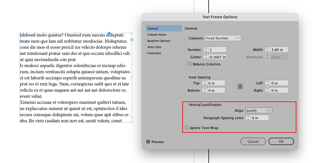

Have you tried using Vertical Justification set to Justify as in the screenshot below? That will adjust the leading to make sure that the text fits the frame exactly. Also, are all of your text frames from page to page the same depth?

Thanks for your reply. I have considered using Vertical Justification set to Justify, but that would stretch the leading across all lines, which I don’t want because it changes the appearance of the text. I want the leading to remain consistent at 14 pt throughout the novel.

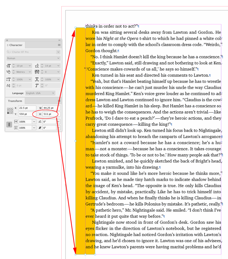

Baseline Options: first baseline offset = Ascender Minimum 0 mm, use custom baseline grid disabled, start 0 mm
Hi @D.D.D_ If you have the Text Frame’s First Baseline Offset set to Ascent, the text’s leading would have to be slightly less than a multple of the frame‘s line count in order for the last line’s baseline to sit on the bottom of the frame.
Here the distance from the first line’s baseline to the bottom of the page is 511 pts and the line count is 36—511/36 = 14.19444. If I change the leading from 14 to 14.19 the last baseline fits, and sits at the bottom of the frame.
Or, if I had to have 14 pt Leading, I would have to change the size of the bottom margin and the text frame’s height:
