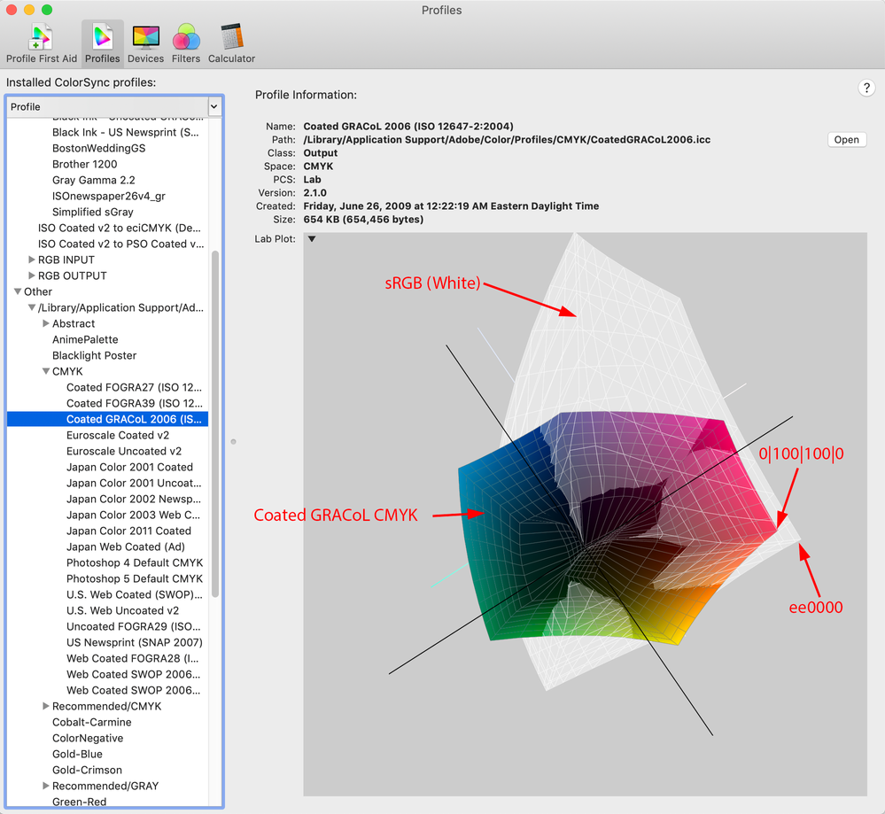

Hi @Chris P. Bacon ,
The article you linked to is referring to web viewing where the RGB color profile is assumed to always be sRGB.
The Adobe print apps allow you to work in any RGB or CMYK space, so the appearance of color is dependent on the assigned color profiles.
Here I have a document with sRGB as its RGB assignment, and Coated GRACoL 2006 as its CMYK assignment. The fill on the left is sRGB 238|0|0 and the fill on the right is GRACoL CMYK 0|100|100|0. If I change the document profile assignments the color appearances change:
sRGB and Coated GRACoL:
sRGB and US Newprint SNAP
Prophoto RGB and US Newprint SNAP
Also, HEX color is simply a different notation for RGB colors, so if I check the 0|100|100|0 CMYK value in the Color Picker, the listed hex value is the conversion from the document CMYK profile to the document RGB profile—Coated GRACoL to sRGB in this case.

That’s right, CMYK is device dependent—its appearance changes depending on the press profile.
