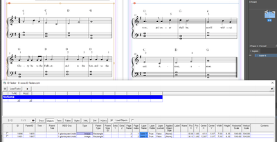

Hi there!  I am using InDesign to write a book of music.
I have my parent pages set up with only two objects:
1.  An 8.5x11 frame for the background object, created outside of InDesign, which includes a graphical header and some other simple elements.  This goes on the bottom layer.
2.  A 7.5x8.35 in frame to import a png of the music I'm writing in Finale.
The frame for the background is working great with no issues.  It's the second frame that's at issue.

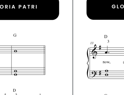

I am exporting the music from Finale by printing it using PDFCreator as a png with the size being defined on PDFCreator 7.5x8.33 inches.  After I "print" it that way, I import it into InDesign.  It seems to me like this should result in a perfect fit, but unfortunately, the second page of music in this example is larger than the first:
Full two-page spread, exported as pdf
Detail from this spread, showing the size difference:
Here's a screenshot of my frame fitting options:
I'm new at this and probably missing something obvious.  Any help would be appreciated.  Thanks!
Melissa

LEGEND , Jul 04, 2024 Jul 04, 2024
@Melissa359683205ypc
Somehow, you've changed the sizof the imported image:
(the brown frame on the lext represents image place inside the Rectangle)
- if you reset it - then both are exactly the same:
(here it is exactly the same size as the Rectangle)
In order to reset your image:
1) use DIRECT SELECTION tool:
2) click on the rectangle - you should see this brown frame - instead of blue one,
3) clear Transformmation:
4) your image will probably slightly move:
5) still using Direct

LEGEND ,
5) still using Direct Selection tool - move it, align its top-left corner with top-left corner of the Rectangle:
Or you can just center it:
New Here ,
WOW!  I would have never figured that out on my own.  Thank you so much!!!  That did the trick.  😄
