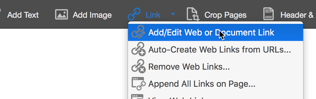

To reliably create links you would have to use the Edit PDF tool, and select Link on the lower toolbar:

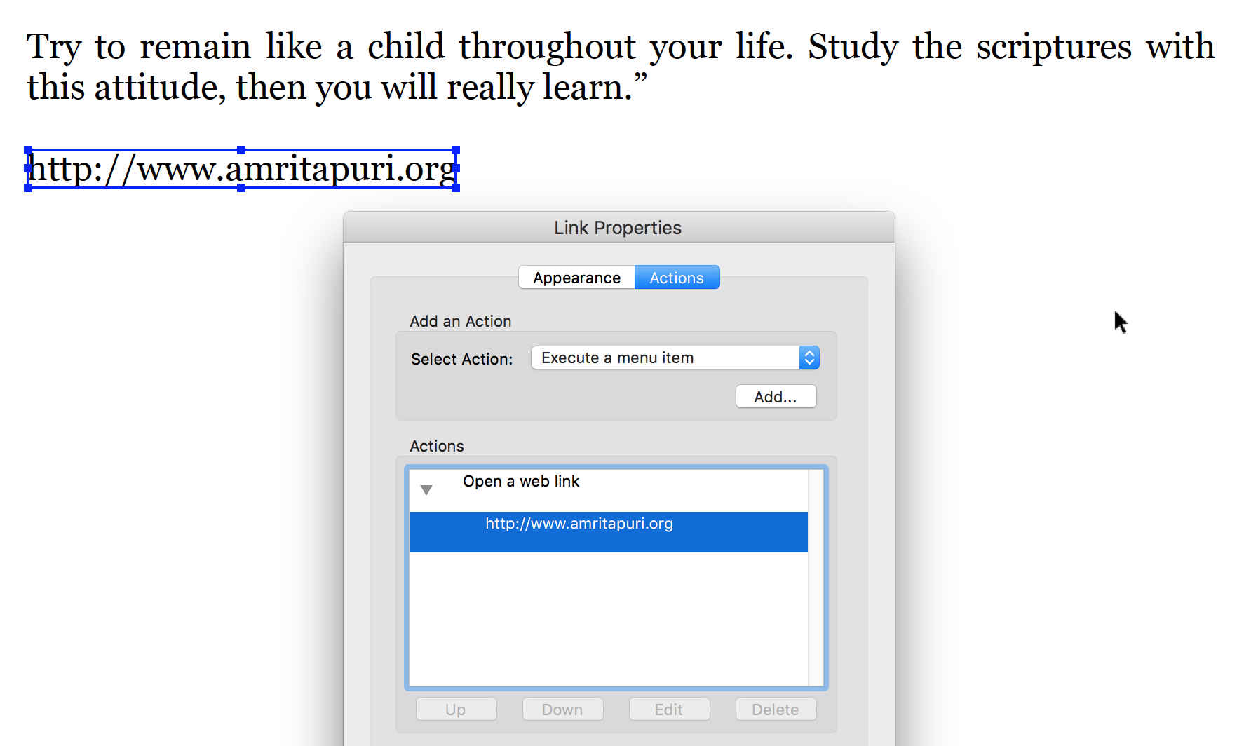

Then you can choose the URL to be used as a web link action:

Steve, could you please repost your last paragraph? The Link Properties dialog that you inserted covers some of the text/
Dec 26, 2017 Dec 26, 2017
Here you go:
