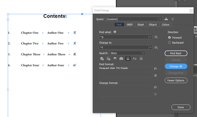

@Willi Adelberger I have reached 98% close to the example. I just need a vertical line next to the serial number. This will make this TOC 98% automatic. No need to convert it to table.
After generating the toc, will have to run grep shown in the screenshot.
I have shared the toc idml and current screenshot.
