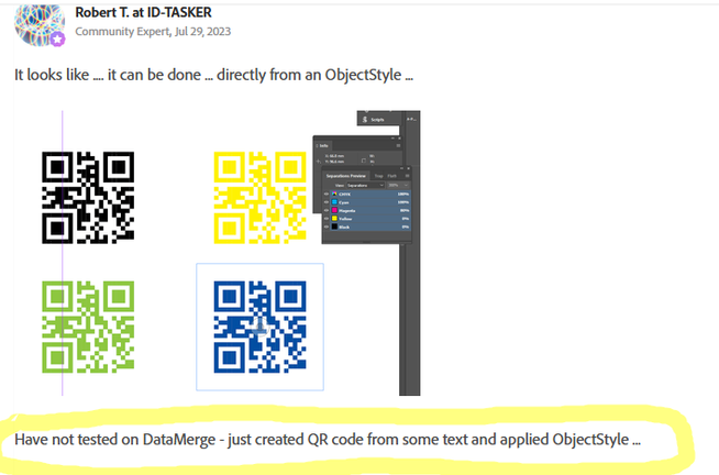

LEGEND ,
Apr 29, 2024 Apr 29, 2024
Community Beginner ,
The method you mentioned is not valid for data merge. For barcodes created individually.
LEGEND ,
quote
By @Mikey Gonzalez
It's based on creating an ObjectStyle - same as @Raskov370700397tup  have recorded.
You are right, the logic is the same. I thought about it this way and tried it, and I was very sad when I saw that it didn't work. But I might have done something wrong. If you want, try it yourself with data merge. I'll be waiting for the result with curiosity.

LEGEND ,
@Mikey Gonzalez
It was at that time - no one continued on that thread so I assumed it's no longer important - but as Raskov has shown - it works on DataMerge as well.
