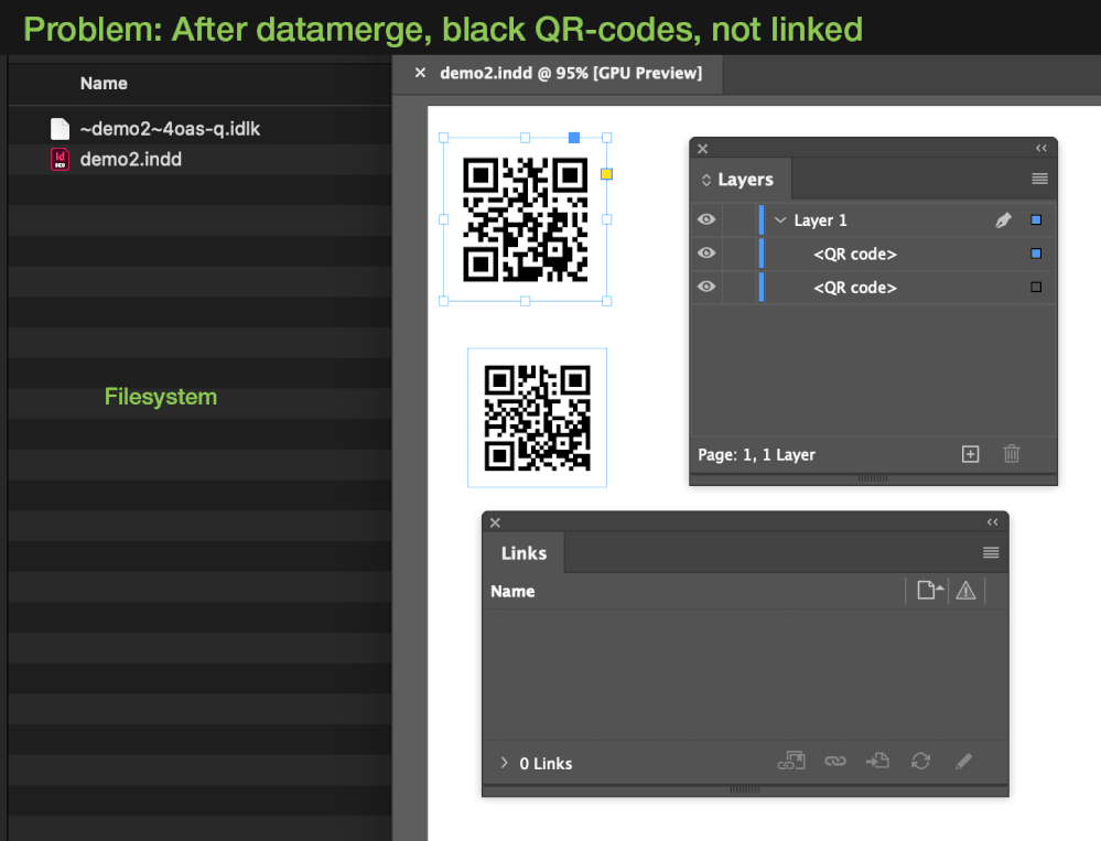

Hello!
I have a ticket that has a QR code on it that the customer wants in their color (blue). When using datamerge, the QR codes are colored black. The DB has 25,000 records. Anyone have a Javascript to accomplish this?
Thanks in advance!

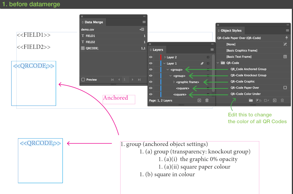

Or — here's a wild-@ss idea — build everything that's to be blue in black, then do a color swap. It could be as little as a few framing objects and the codes, convert to blue, build the rest of the document.

Seriously vague, seat-of-the-pants, hand-waving idea. I was thinking of various ways to export and then place on a different color layer, etc. Not sure any of my Rube Goldberg ideas would work.
It still seems like a script to edit each code and reassign the color swatch is the most... efficient approach.

Hi @budatlitho, I had another idea! I've written a script that converts the "datamerge" qr-codes into linked .eps files (sorry they have to be .eps for technical reasons) saved into the same folder as the document. I have no idea how well this will do with 25,000 qr-codes though—it might be very slow—but the resulting document might ultimately be neater than doing it the masking way. Not sure. Also the script can re-color the linked qr-codes, even after they've been colored once. If you use it, et me know how it goes, and report any bugs back here. 🙂
- Mark

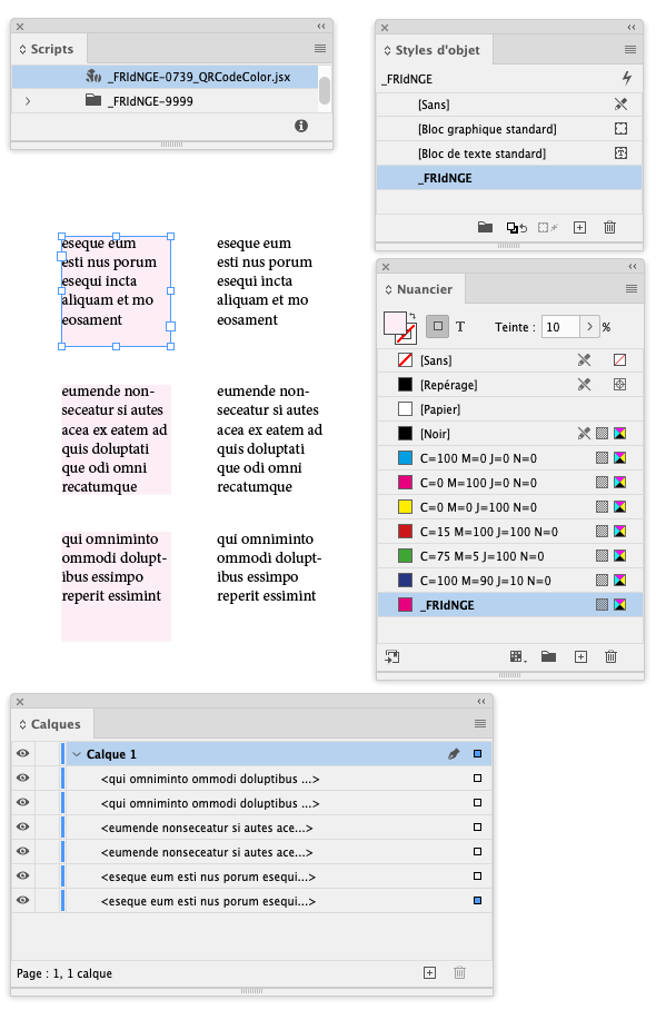

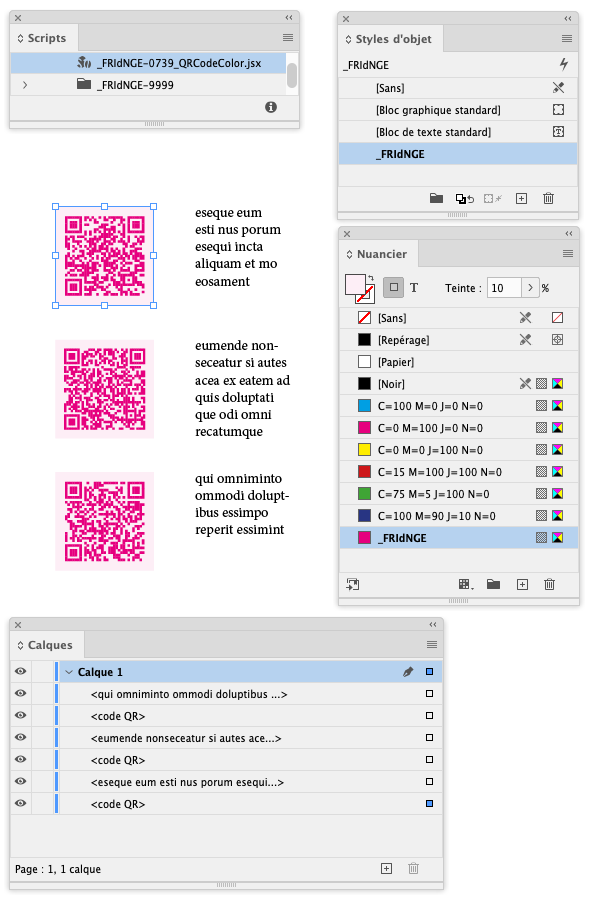

Guide ,
Jul 28, 2023 Jul 28, 2023
Guide ,
As James and Robert suggested at the beginning, simply:
• define a '_FRIdNGE' color,
• define a '_FRIdNGE' object style applied to the frame that will receive the QR-Code,
• make the data merging importing QR-Code text as plain text,
… and finally, play these 2 code lines:
var myItems = app.activeDocument.allPageItems;
for (var i = 0; i < myItems.length; i++) if (myItems[i].appliedObjectStyle.name == "_FRIdNGE") myItems[i].createPlainTextQRCode(myItems[i].contents, "_FRIdNGE");
