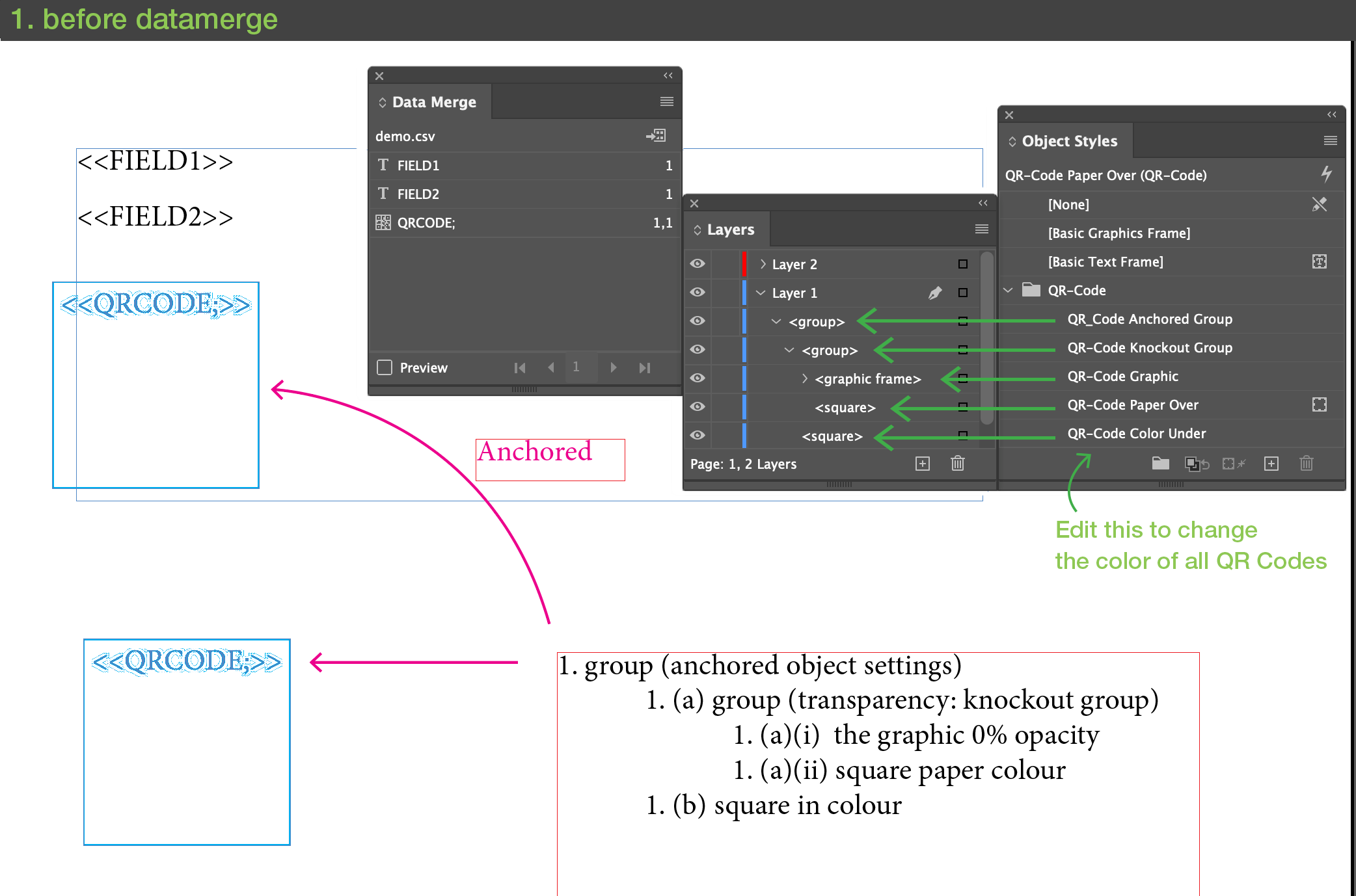

I had a look into this just now, @budatlitho, and it isn't as easy as it should be. Even using a script to set the color after merging is difficult. I think the most practical way is to use this masking technique to apply the color. It seems complicated, but once you understand what it's doing you can work with it fairly easily in most cases. I've made a demo .indd and a .csv which I've attached to this post if you want to see how I set it up. I used an Object Style for each component of the technique. Have a look at this graphic—it shows the object styles I made and which page item they apply to, before and after merging. I've made an anchored in text version as well as a normal version just for the demo. Note that you can only see the result when viewing the document in High Quality Display mode.
- Mark

The idea to use the black QR code with another object on top and an effect to color the code is the best one, I think.
Unless you want to write a script that creates all codes from scratch using the information of the black code. You'd have to pull this out of the XML of a InDesign snippet *.idms file.
- Mark
