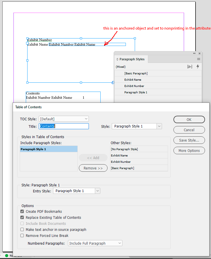

I think I would take a different approach. The paragraph rule would work if this was a separate paragraph, and the only thing keeping you from that is you want to concatenate with the next paragraph in the TOC. I would use two paragraphs, the create a new style to use for the TOC entry and add a concatenated string using that style as an anchored object at that position in the text flow. You can make the type invisible for the concatenated string in the body, but visible in the TOC.

Just tested this and splitting the two lines with a paragraph break does not affect the behavior of the paragraph rule:
It could, however, allow James Gifford's paragraph border workaround to work, so maybe it will come to this.

If the rule is applied (most likely as rule below) to a single paragraph that is just the exhibit number, then you have the exhibit title as a second paragraph, that should work. Here's how:
Replace the forced line break with a paragraph return.
Copy the two paragraphs and paste into a new text frame. Replace the paragraph break in that frame with a space (or forced line break if in fact you want the TOC entry on two lines). Assign a new pargraph style to the text in the new frame. Define that style so the text is invisible if you like, or set the frame to non-printing (which is probably better since you can still see it while editing), then cut the frame and paste into the text flow at the end of the second paragraph so it becomes an anchored object.
Redefine your TOC Style to include the new pararagraph style for the invisible text instead of the old paragraph style you used for the text with the forced line break.
