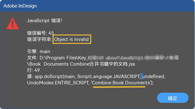

Apr 26, 2025 Apr 26, 2025
Hi @dublove here is a quick attempt to combine all book documents into one. It can be a complex task depending on the specifics and complications involved, but this script takes a simple approach. Use with care.
- Mark
 * @file Quick Combine Book Documents.js
 * Combines a book into one document by simply (naively!)
 * duplicating the pages to the end of the first document.
 * See "PARTIAL LIST OF ISSUES" under documentation for
 * `duplicateSpreads` function below.
 * @author m1b
 * @version 2025-04-27
 * @discussion https://community.adobe.com/t5/indesign-discussions/how-to-merge-documents-in-a-book-into-one/m-p/15290043
function main() {
    if (0 === app.books.length)
        return alert('Please open a book and try again.');
    var settings = {
        closeBookAfterCombining: false,
        closeBookDocumentsAfterCombining: true,
        combineSpreadsAtJoins: true,
        removeSections: true,
        revealCombinedDocument: false,
        saveCombinedDocument: false,
        showUI: true,
        target: app.books[0],
    if (
        settings.showUI
        // show ui
        && 2 === ui(settings)
        // user cancelled ui
        return;
    if (!settings.target.hasOwnProperty('bookContents'))
        return alert('Target must be an Indesign Book.');
    // the docs to combine
    var docs = [],
        book = settings.target,
        bookContents = book.bookContents.everyItem().getElements();
    // open all the book's documents
    for (var i = 0; i < bookContents.length; i++)
        docs[i] = app.open(bookContents[i].fullName);
    // open the combining document as a copy
    var combinedDoc = app.open(bookContents[0].fullName, true, OpenOptions.OPEN_COPY);
    if (!settings.combinedName)
        combinedDoc.name = book.name.replace(/\.[^\.]+$/, ' combined');
    // duplicate the spreads into the combined document
    for (var i = 1; i < docs.length; i++)
        duplicateSpreads(docs[i], combinedDoc);
    if (settings.removeSections)
        // remove all sections except first
        while (combinedDoc.sections.length > 1)
            combinedDoc.sections.lastItem().remove();
    // join adjacent single-page facing-pages spreads
    if (
        settings.combineSpreadsAtJoins
        && combinedDoc.documentPreferences.facingPages
        combineAdjacentSinglePageSpreads(combinedDoc, false);
    if (settings.closeBookDocumentsAfterCombining) {
        // close all except the combined document
        for (var i = docs.length - 1; i >= 0; i--)
            docs[i].close(SaveOptions.NO);
    if (settings.saveCombinedDocument) {
        // save the combined document
        var path = String(book.fullName).replace(/\.[^\.]+$/, ' combined'),
            n = 0;
        // add a number to avoid overwriting
        while (File(path + (n ? ' ' + n : '') + '.indd').exists) n++;
        var f = File(path + (n ? ' ' + n : '') + '.indd');
        // save it
        combinedDoc.save(f);
        if (settings.revealCombinedDocument)
            f.parent.execute();
    if (settings.closeBookAfterCombining)
        // close the book
        book.close(SaveOptions.NO);
app.doScript(main, ScriptLanguage.JAVASCRIPT, undefined, UndoModes.ENTIRE_SCRIPT, 'Combine Book Documents');

Is there a requirement for the filename of the storage?
There is an error message
Hi @dublove the error is "Object is invalid" but I can't tell where the error is occurring. Can you post a small sample that still has the error?
Otherwise, try changing this line:
 to:
main();
It will still get the error, but the error message will tell us which line which might be enough.
- Mark
