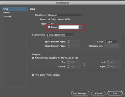

You can print a select range within Print Booklet. Keep in mind the value you enter relates to spreads. My example is a 16 page booklet, and 3 will print the 14-3 spread.
Edit: the range relates to pages, not spreads. In this example, I need to enter 3,14 to print the third spread.

I noticed you have Perfect Bound selected as the booklet type, is this the method that you need? As opposed to 2up Saddlestitch?
Copy link to clipboard
Copied
Yes. I can't remember why, but the 2-up perfect bound is what worked for me. Maybe because I was able to select signature size?

With Perfect Bound method, I am unable to select a range.
My suggestion would be to export the pages (single page PDF) that you need to reprint, and compose a new printer spread document, not using print booklet function.

I just tested and the saddlestitch method will not allow a range.
So with that said, my suggestion is export PDF of all the necessary pages that you need for the reprint. You said page 87, so you would need 73, 74, 87 and 88. Then create a new 2 page Indesign document that is the size of a printer spread, placing each PDF to create 88-73 and 74-87, then print.

Stop the Press! In print booklet, you are specifying the pages, not the spread for the range. In my early example, I selected 3 in range with the expectation that this would print the third spread. I actually need to enter 3, 14 or if I need the backup as well, 3,4,13,14. This works for perfect bound and saddlestitch. And you if you were to use Acrobat's booklet feature, you would enter pages for a range the same way.
Brian, try entering 73, 74, 87, 88 into your range and see if this works.
