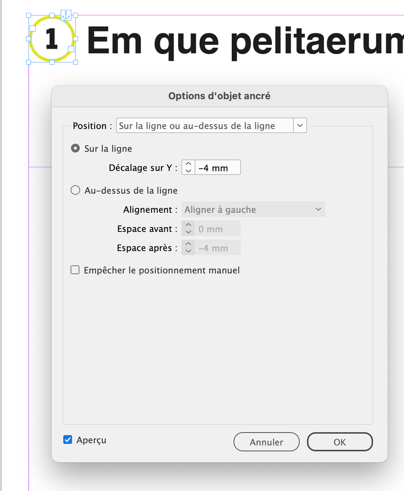

Aug 09, 2024 Aug 09, 2024
Did you try to create circled text frames directly in InDesign and then anchored them at the beginning of each line in uour main text frame?
Community Beginner ,
Aug 11, 2024 Aug 11, 2024
No I havent tried to do this, but I can.  Where would I find this window you screenshot?
Aug 12, 2024 Aug 12, 2024
Select the anchored object and go to the Object menu > Anchored object.
Just to be sure, I remind you how to anchor objects:
  1. Create the circled frame, type the number*, adjust the number alignment inside it
  2. Copy the frame with the black arrow
  3. Switch to the type tool
  4. Position the cursor at the beginning of the line in the main text frame
  5. Paste
* you can use a list to automatically number each frame
