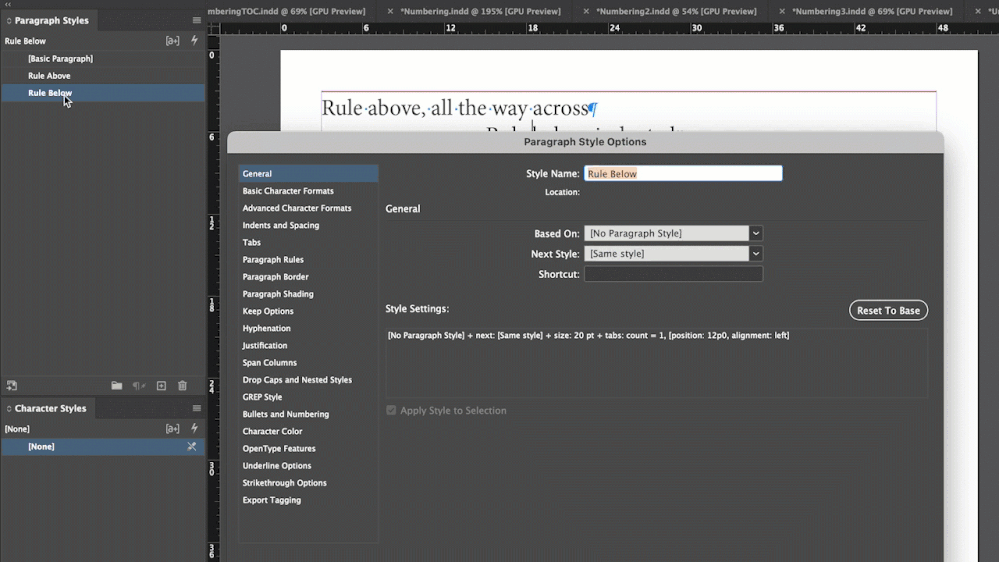

Specifically how they relate to Paragraph Styles. And even particularly when typing to make empty empty spaces with rules. I select my new Paragraph Style "Rule Below" and as soon as I select it, the entirety of my text now has a rule on it. It's even hard to explain what my problem is.
If I want a predetermined Tab area to be an area with just a rule and no type, how can I do that? As soon as I select my Rule Paragraph Style it just applies the rule to everything. This is irritating beyond belief. And every time I look for a guide on working with Rules it isn't comprehensive enough to deal with a scenario of "Rule on - Rule off" wherever it's needed. Especially with empty space. Please help. I'm losing my mind.

Hi @Prenihility , Maybe this helps a bit with the rule Offset logic.
When you choose Rule Above the rule starts at the baseline of the paragraph’s first line. A positive Offset moves the rule further up:
When you choose Rule Below the rule starts at the baseline of the paragraph’s last line and a positive offset moves the rule further down:

Also, I create a fresh document and try and do this myself. Rule below. New paragraph style. Very basic. Rule Below, offset it so it's actually below. And then I get a rule IN the letters also. It looks like a strikethrough. HOW?

Hi @Prenihility:
You will need to adjust the offset values to control the rule's vertical position.

I actually noticed this before; last time I tried messing around with this file. You can see in the Style Settings it lists among other things Rule Below for one of the styles. But HOW? Rules isn't even checked on.

The tabs are controlling the position of the text. They have nothing to do with the rules.
Your screen shot shows Ruling Line Below 0.5pt, Ruling Line Offset: 0p9.

Ok, so after further inspection, the Paragraph Styles share the same tab markers. So my question is simple, how are differently sized Paragraph Rules being created with the different Paragraph Styles. I see no clear reason for it, or how it was set that way.

Rule isn't even checked off in either of the Paragraph Styles. So as soon as I think i've figured it out; nah.

Alright, so after some investigation, I understand the method to my teacher's madness. He's using columns to use as guides for the Tabs. Makes sense. In the first screenshot you'll see the 6 columns visible. In the second i've disabled part of the UI so you can see it with less clutter. Special Characters are also visible in the first screenshot.
So what doesn't make sense to me is how everything is set. There are different Paragraph Styles. Rule Above, Rule Below. No Rule. If the rules are set from Tab Marker-to-Tab Marker, i'm having trouble understanding how a rule is set all across the entire width of the document. I... KIND OF think I understand it more. I see NO DIFFERENCE in some of the Paragraph Styles. Other than tab settings IN THE PARAGRAPH STYLES. I didn't pay much attention to those. And it actually interacts with the document UI and you can see it in real-time.
