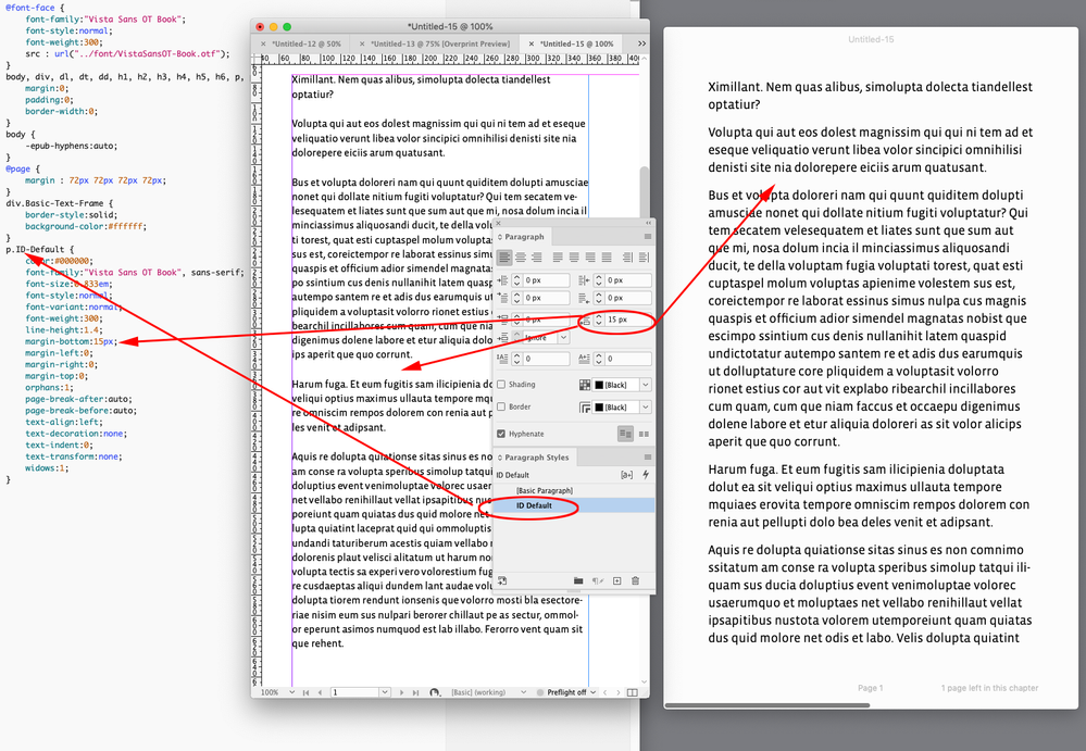

As I mentioned above in my post from last year HTML doesn’t allow you to create space with empty paragraph returns—you have to use the CSS margin or padding property. If you generate a CSS style sheet with the epub export, InDesign Paragraph Styles with Space After will export to a CSS style with a margin-bottom property in pixels. The CSS pixel dimensions are device pixels, but the InDesign pixel dimension is a static print output dimension of 1/72", so the InDesign print white space and the displayed HTML white space will not match exactly:
You can unzip the epub file and edit the CSS—the margin-bottom could be set as a percentage.
Jun 24, 2021 Jun 24, 2021
Or you can write your own CSS and add it during the export.
