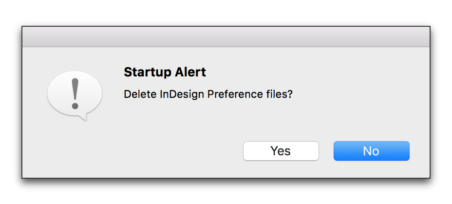

As for erasing the preferences file, it's trickier than it sounds. Get your four fingers ready on your one hand, hovering over Shift, Control, Opt and Command. Double click the InDesign icon in the dock and then immediately press and hold down all four keys until it the following message appears. It usually takes me a few tries.

I then moved on to successfully erasing my preferences, the page I previously read about that on wasn't clear that it required exact timing, so thank you.

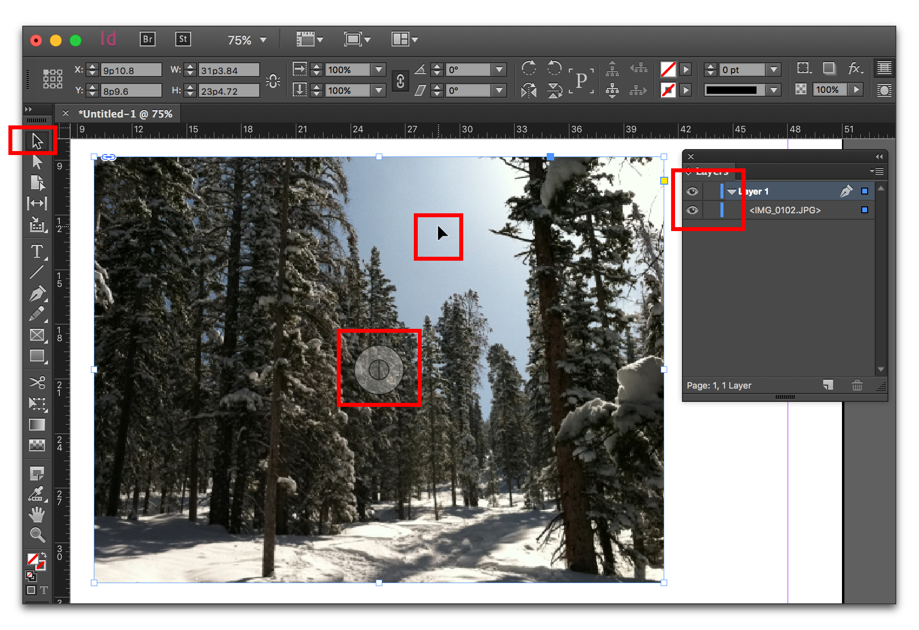

First of all, congratulations on deleting the preferences! It's a peculiar sequence.
So you are trying to move a graphics frame... using the Selection tool (the black arrow) and pressing your mouse down inside the frame while simultaneously avoiding the doughnut in the middle?
Working from left to right: the first red rectangle shows the Selection tool, the second shows the doughnut to avoid, the third shows the cursor inside the frame but away from the dreaded doughnut, and the fourth shows that the image is not locked.

That is exactly what I am doing and yet the image will not budge. The donut doesn't work either.
Apr 18, 2016 Apr 18, 2016
But the sizing handles are visible on the sides and corners?

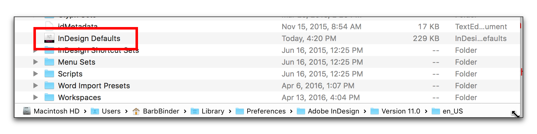

Ok, I can help with that... open Finder, open the Go menu and then press Alt while the menu is down and watch the Library menu show up. (It's hidden so that you won't stumble into and start messing stuff up.)
From there go to Preferences > Adobe InDesign > Version 11.0 > en_US and delete InDesign Defaults (note the path on the bottom of the screen shot):

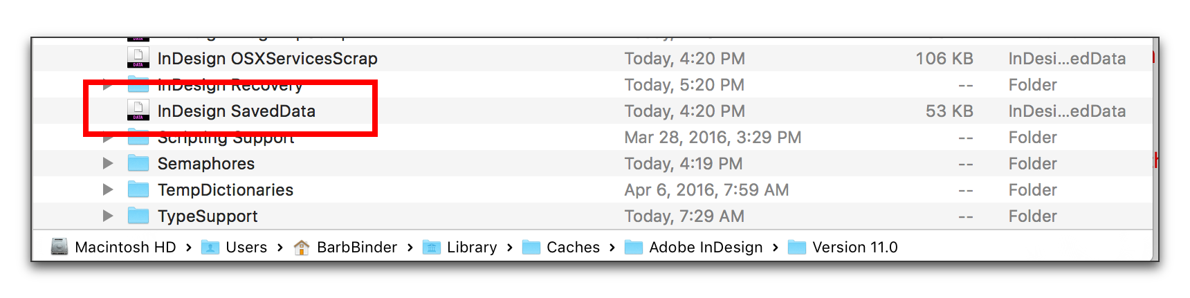

Start over with Opt+Go in Finder, from there go to Caches > Adobe InDesign > Version 11.0 and delete InDesign SavedData.Finderss_002.png
Restart InDesign.
