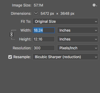

I am putting an image into an image frame in Indesign. When I highlight the frame the dimensions are 4" x 4". Here are the specs of the image when I pull it into Photoshop:
When I drop the image into the frame on InDesign and highlight it the dimensions are now 4" x 2.6". Why?

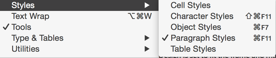

Object Styles is a panel, which can be found in the Window menu. It's also in the Advanced workspace (but not the Essentials workspace.)

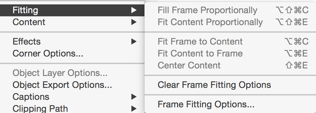

You can also select the frame and go to Object > Fitting > Frame Fitting Options to see what has been set for the frame.
