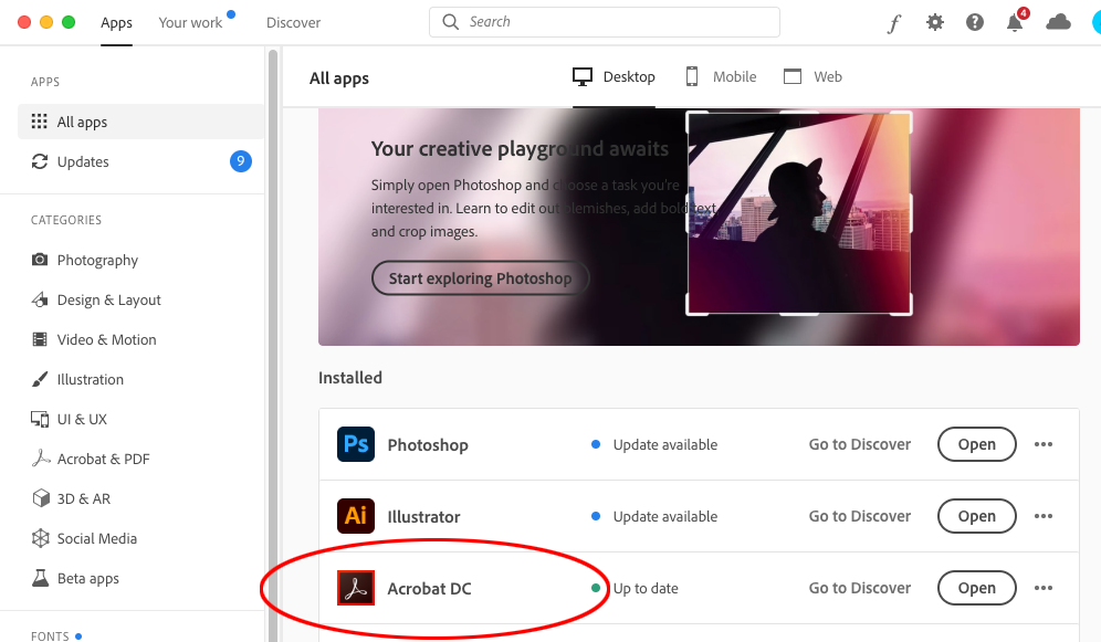

I don't have Acrobat Pro cause it's not in CC.
It should be available:

@ rob_day I wasn't able to install Acrobat DC. It's in the list but not availabe for download.

" It's in the list but not availabe for download." What happens? Seriously, it is part of CC for everyone (with compatible system) and an indispensible prepress tool.
Aug 04, 2020 Aug 04, 2020
Sounds like something is wrong with your CC app. There’s no way of knowing what’s in a PDF without AcrobatPro.
