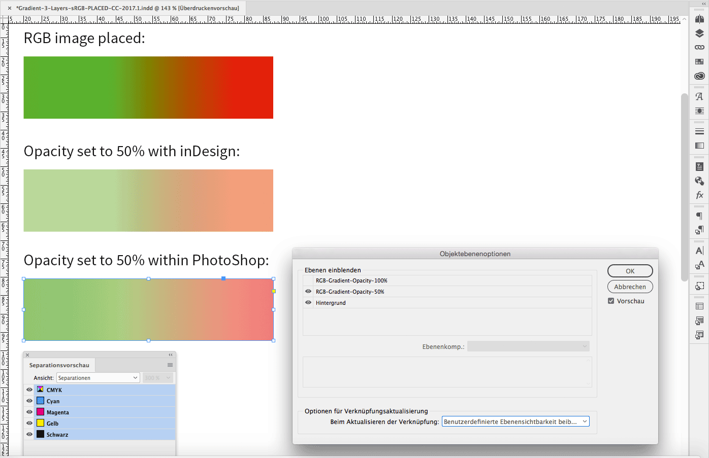

FWIW: Separation results could be different of placed RGB images where reduced opacity is used within the image ( e.g. a layer option with PhotoShop is used ) in comparison to opacity effects applied by InDesign's Effects panel applied to a not transparent RGB image.
Below an example that is demonstrating this.
The same PhotoShop image with three layers placed three times.
The PhotoShop layers from top to bottom:
Layer 1: Opacity 100% showing a gradient
Layer 2: Opacity 50% showing the same gradient
Layer 3: Background Layer with fill color RGB 255|255|255 ( a "white" )
Now the image is placed 3 times on an InDesign page.
See screenshots from my German InDesign below.
Case 1 on top: All 3 layers are turned on. No effective opacity is visible.
Case 2 below: Exactly as case 1 with one difference:
An effect from InDesign's Effects panel is applied:
Opacity is reduced to 50 %
Case 3 at the bottom of the page:
Layer 1 is turned off. In effect you see the gradient of layer 2 with opacity 50% on the background layer that is filled with white.
Perhaps you would expect that 2. and 3. will lead to the same separation?
Apparently that's not the case.
Image of case 2 selected, Separation Preview on:
Image of case 3 selected, Separation Preview on:
So be careful what you are doing with effects on InDesign objects on the page.
The separation result of case 3 is much better than the one of case 2.
If you can, avoid RGB colors for text and vector objects in InDesign.
At least avoid tints on RGB swatches. You'd see the same separation values like in our case 2 that are not optimal. *
RGB fills that are not touched by InDesign effects and do not come with tints will separate as expected when output to PDF/X.
That goes for exported PDF/X-1 and PDF/X-4 alike.

Uwe, try setting your transparency blend space to RGB. In that case I get a match both in appearance and separation numbers.
Photoshop doesn't have the challenge of dealing with multiple color spaces on a single page when transparency is applied. The blend space in Photoshop would be the mode of the document—RGB in your example.
CMYK blend space

Apr 09, 2017 Apr 09, 2017
https://forums.adobe.com/people/rob+day  wrote
Uwe, try setting your transparency blend space to RGB. In that case I get a match both in appearance and separation numbers. …
Hi Rob,
I tried that, but unfortunately changing the blend space to RGB was no success.
Here a link to my samples where I also tried different things with RGB based spot and process colors and L*a*b* based spot and process colors. Transparency applied with InDesign's Effects panel would still be a problem to me:
( Perhaps we should discuss this in a different thread… )
I think so.
I can see the problem in 2017 and it looks like a significant bug to me. I saved your 2017 test file as an .IDML and opened it into CC2014 and there the blending spaces work as expected. Over in 2017 it looks like the blend space gets stuck on CMYK. 2017 and 2014 are producing different separation values for the same files.
Here's your file dropped back to 2014 with the blend space as RGB and you can see that the blends match both in appearance and output numbers. I agree this is not happening over in 2017.
