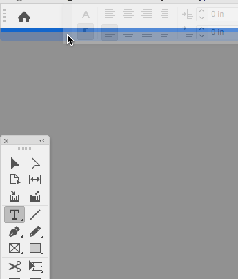

Maybe try docking it by dragging the left bar up into home icon:

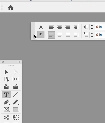

Then if you undock it you should be able to get at the lower right corner to resize:

Dock it to the top, turn on the application frame and then pull it out of the dock. Does that give you enough room?

OH MY GOD - I COULD KISS YOU! : )  Docking it to the top, then unhooking it from the dock and re-sizing it worked! Mwah, Mwah! Thank you!
