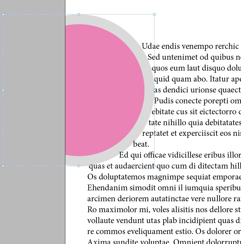

In InDesign, I'm trying to wrap text around the right side of a circle. Simple, right?
See image. Note how on the bottom half of the circle, the lines of text aren't meeting the text wrap boundary like they are on the top half. See the last five lines of text. The effect is that the space between the circle and the text doesn't look even all the way down. I've messed with many different settings and can't figure it out. Any help would be appreciated.

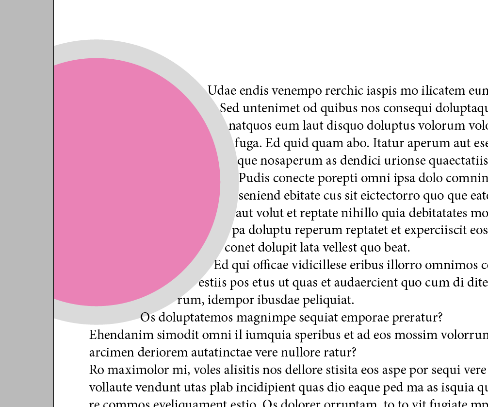

Do you like it like this!
For those who could doubt, I've duplicated the "red" circle and increase its size to make the limit of the text it wraps more visible (in "grey")!
… The result is … quiet perfect!

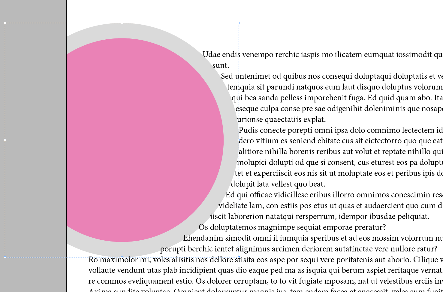

I've grouped the 2 circles and now I can play with them! … Reduicing them:
… or increasing them:
