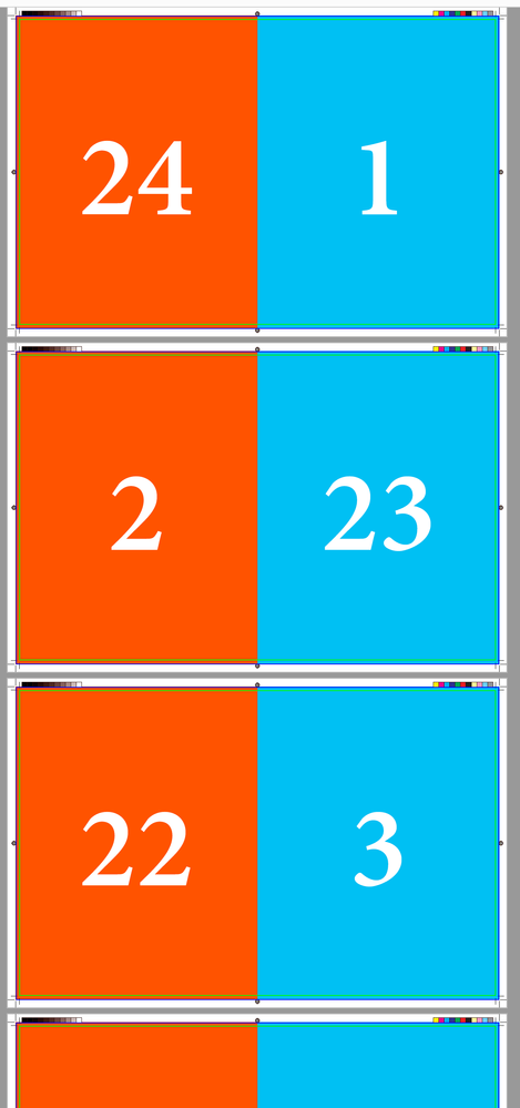

Using InDesign's Print Booklet does things properly. Unfortunately, what it can't do is Export a PDF that way, Right now the only way is to to Print to Postscript (using the Acrobat PPD mentioned earlier) and Distill a PDF from that (or: If you have a Win machine and an Acrobat PDF (or any PDF printer driver installed), you can forego the print to Postscript step and Print from InDesign's Print Booklet directly to your PDF printer driver).
The drawback here (and this is what gets "people" up in arms) is that printing this way requires flattening of the file (transprency effects etc), but for your own printer of even your familiy's printer, this is not a big deal and will likely have zero impact in the quality of your printout. Of course, you never want to do this to send to a professional printer. Even decent copyshops can properly booklet proper PDF files from properly made single page PDFs.

For simple in-house impositions, you can try this script—it imitates Print Booklet, but Exports the imposition:
https://shared-assets.adobe.com/link/3bfdb004-f188-4f3d-5904-d82dd8f8e2d1

Yes you can "print" the pdf to a PostScript file (when you choose which printer) and then open the .ps file in Acrobat Distiller, this will then generate an imposed PDF.
