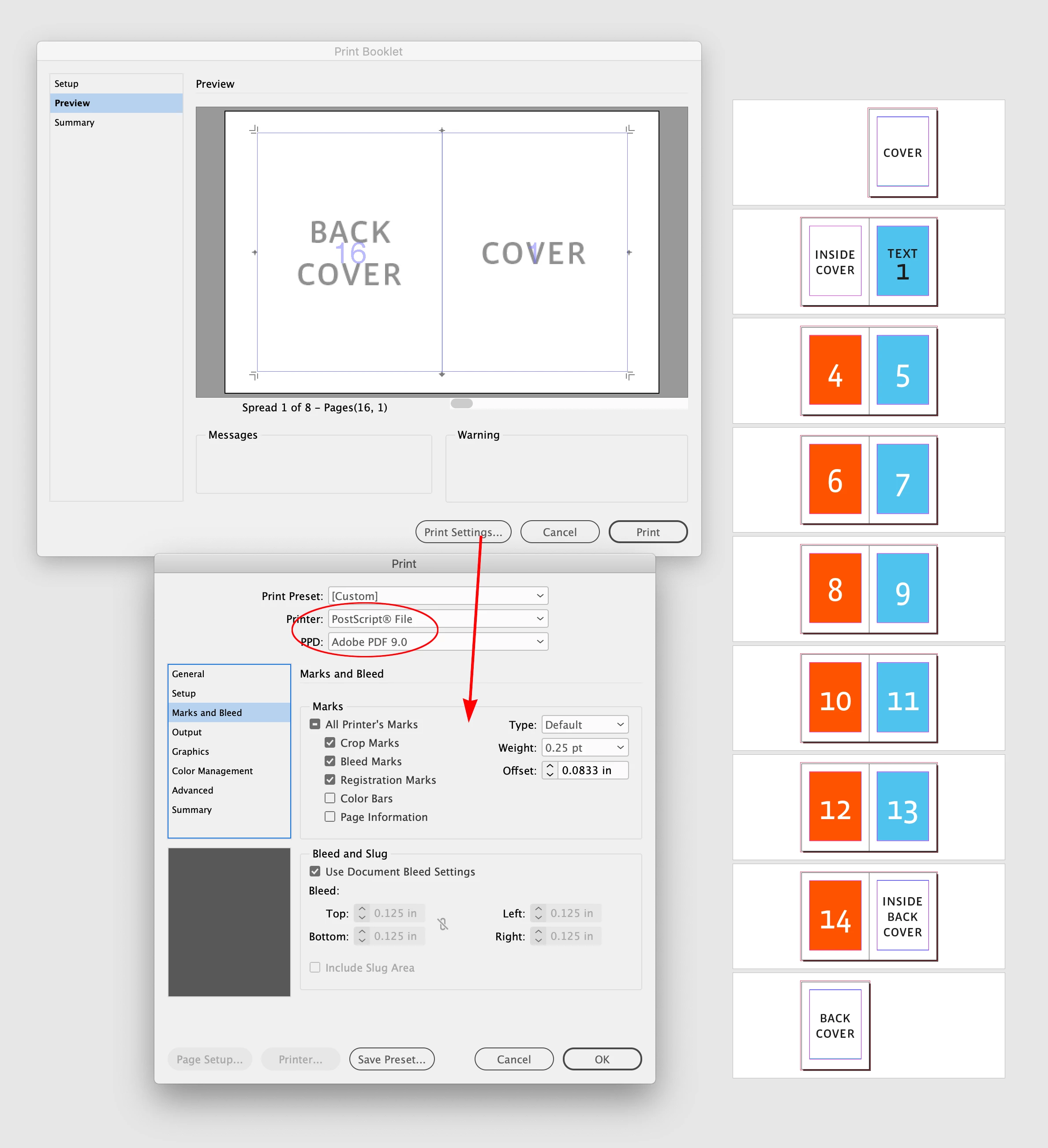

Instead of printing an InDesign booklet (with correct imposition) is it possible to instead export it as a PDF?

Hi @mttplbkp , InDesign’s Print Booklet has more imposition features than Acrobat’s Booklet—you can impose for perfect binding, set signature sizes, add a creep amount, apply printer marks.
In order to Print a postcript file you need to install the Adobe PDF 9.0 PPD, which can be downloaded from this page:
https://helpx.adobe.com/indesign/kb/add-acrobat-ppd.html

No, and I'll add my usual soapbox statement:
There should be no reason at all to provide anyone with an imposed document. If you're using this for inhouse printing, export a proper PDF and use Acrobat's booklet printing feature.

Thanks, but is it possible to do this whilst including bleed + crop marks?
If I export a PDF as individual pages (with bleed / crop marks) then I end up with a gap in the middle of the spread when I go to print as a booklet from Acrobat

Inside bleed should be set to zero.
