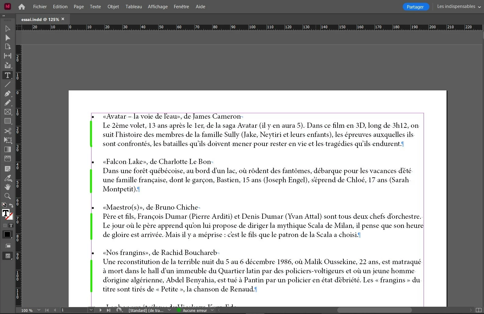

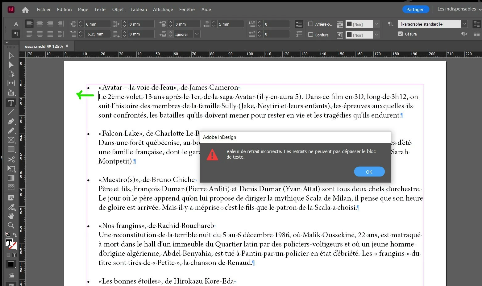

I have created some bullets in this screenshot.
For each paragraph, about the lines after the bullet point, I would like to move these lines to the left, at the green line on the screenshot. How to do this ?

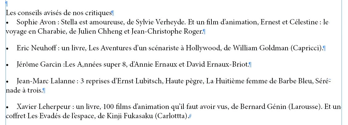

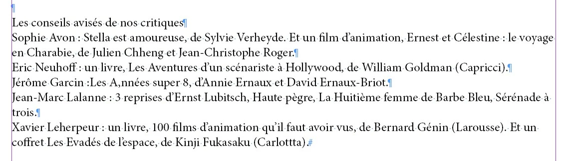

December 17, 2022
1) About the text of the page bottom :
I have set a paragraph style with :
- the bullet setting you see below.
- a space between paragraph
Here is the result after applying this paragraph style (the second line after the bullet is completely at left) :
2) About the text of the beginning of the page :
I have used another paragraph style (on the paragraph title only) with :
- the same bullet setting as before.
- italic style
Here is the result (the second line after the bullet is completely at left) :

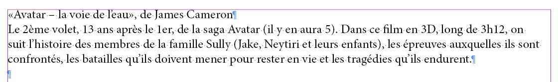

December 17, 2022

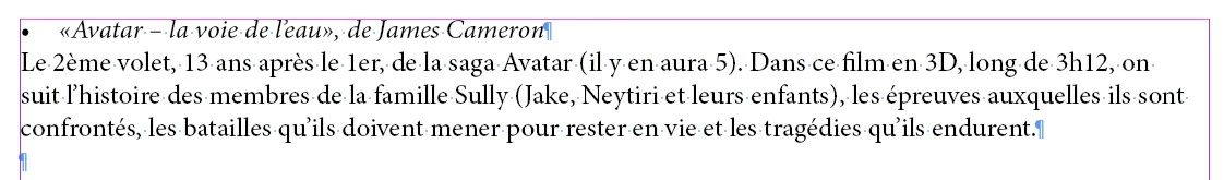

I have done 2 paragraphs : a paragraph for the title of the film (in talic with a bullet), and another paragraph for the description of the film (that is as I expected : completely at left) :
But now, at the green arrow in the screenshot, it is different :
- I don't want to separate the first line and the second line (one single paragraph).
- I would like that the phrase beginning at the first line could continue on the second line, but completely at left on the second line.

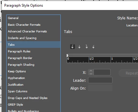

Eric Dumas
December 17, 2022
I always found the 'Tabs' options weird to set up (Ctrl+Shift+T) or even better in paragraph styles.
  • The top 'triangle' represents the position of the start of the line, the position of the bullet point
  • The lower 'triangle' represents the position of the rest of the text (until the next carriage return that will place the cursor at the position marked by the top triangle)
  • The weird thing is that a user needs to move the top triangle first, then move the bottom one, then re-position the top one to its correct place (moving sometimes the 2 together...)
  • Just make it harder, the triangle are really hard to grab without adding more tabs (bent arrows), especially on smaller screen or interfaces. At least, we can select one and type a X value, which is easier and more accurate

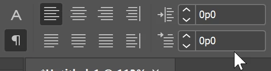

December 17, 2022
In each bullet , my goal in each parapgraph is to keep the first line unchanged, and move the other lines to the left (see green arrow in the screenshot).
So I put my cursor on line 2 and tried to change the left indent, but indesign show me an error window with : "incorrect indent value. The indents cannot go beyond the text frame" (see screenshot).
I have also tried to use optical margin alignment, but with no success.
Peter Spier
December 17, 2022
Set the first line indent back to zero as well.

Maybe have the textframe selected and turn on Type > Story > Optical Margin Alignment

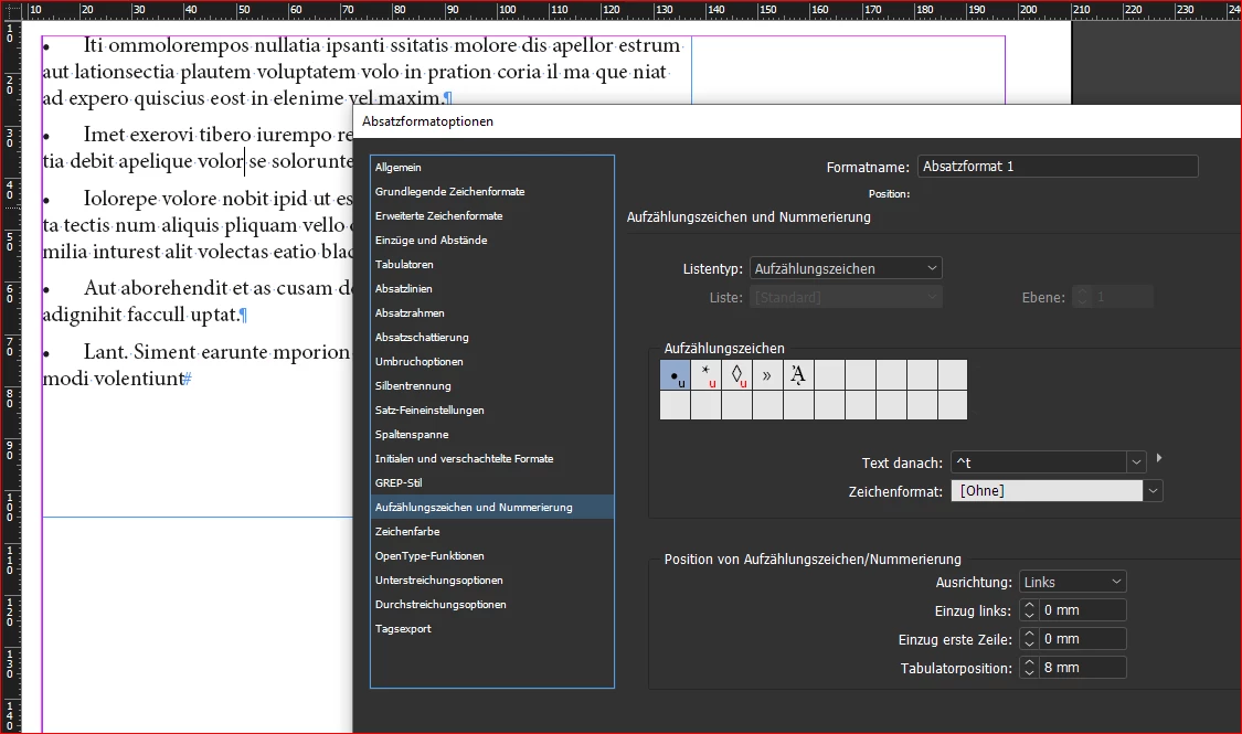

barbara_a7746676
December 17, 2022
Your indent settings should look like this:
Peter Spier
December 17, 2022
Set the left indent on the style to 0
