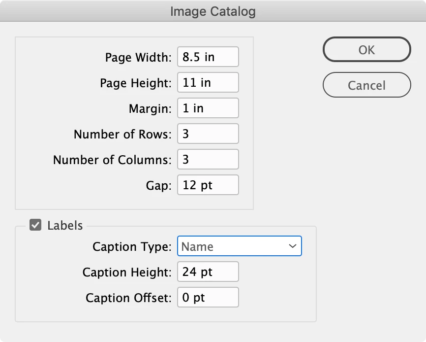

Hi @Danique van Hulst , The original post is from 2008, so it‘s unlikely Sean will see your post. Did you try ImageCatalog.jsx as @_Olav_Kvern_  suggested? I would be in your Scripts panel under Samples. Also, you are welcome to try this catalog script, which is a newer version:
https://shared-assets.adobe.com/link/c3a862d0-ea53-4c7d-6b60-0ac39bf901f5
Dialog:
Dialog:
