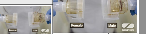

No answer for you, but the same thing is happening for me! Mine is like a map with pop-up captions on it. The captions (which are hidden-until-triggered, actionless buttons) are on a layer ABOVE the marker buttons in InDesign, but Acrobat still displays the markers above the captions. I even tried removing all of the actions from the buttons in InDesign and adding them in Acrobat, but it still didn't work. Here's a screenshot from Acrobat of the caption showing up behind the orange markers instead of on top of them:
Also, you can see that the corner of the caption is disabling the rollover state on the marker - it should be covering up that little orange piece. What is going on!?!

Are you trying to put static content above interactive content? I'm not
an expert in interactive PDF by any means, but I don't think that's
going to work.
Hopefully one of the PDF gurus will stop by and be able to confirm that.

The captions are buttons too (just with no actions on them), so I was hoping it would treat them as interactive content, but maybe it doesn't! Maybe I will try adding an  action to them to see if that helps. If not, I'll try the re-stacking idea, but that will take a long time since I have tons of them! Thanks!

It seems that for interactive elements, the stacking order is determined by the order in which the objects are converted to buttons. Try removing not just the actions, but turning them back into objects. Or, convert them into buttons in the oppsite order than you did the first time. It's maddening, but it should work. Apparently, button creation order trumps actual stacking order. Weird!

YAY!! It was the stacking order! And that seems to have solved the rollover transparency issue too. I will just have to undo/redo all of them now, but I'm so glad there's a solution. Thanks so much!! I will definitely remember that for the next project.
