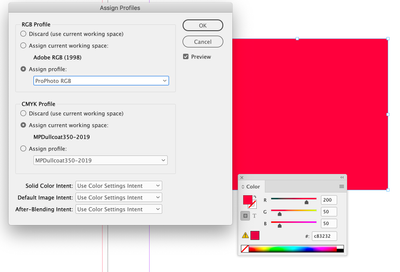

Here’s an example of the color mangement problems you could run into with RGB .eps files.
On the left is the .eps in Illustrator with the RGB color assignment set to Adobe RGB. On the right I’ve placed it in two InDesign documents, and because the EPS can’t be saved with its profile embedded, the color changes depending on the InDesign document’s RGB profile assignment (Edit>Assign Profiles)—top is sRGB, bottom is ProPhotoRGB:

That option has nothing to do with color mangement and .icc profiling—it simply converts the .eps to unprofiled CMYK. If you uncheck it, the RGB eps still is saved with no embedded color profile, which means the color display will be inconsistent.

If he always is using e.g. sRGB for output and as document profile not much can go wrong
Hi Uwe, that is a big if, and wouldn’t be practical when the file is shared—everyone in the organization would have to be constantly checking  document RGB assignments.
Also, @thomasb14279947’s 0|0|255 blue is not really affected by the profile assignment because it happens to be on the edge of the RGB gamut, so the value of an embedded profile is not obvious in that particular case. How much a color appearance changes depends on where it is in the RGB space—something like 200|50|50 does this as the assignments change:
