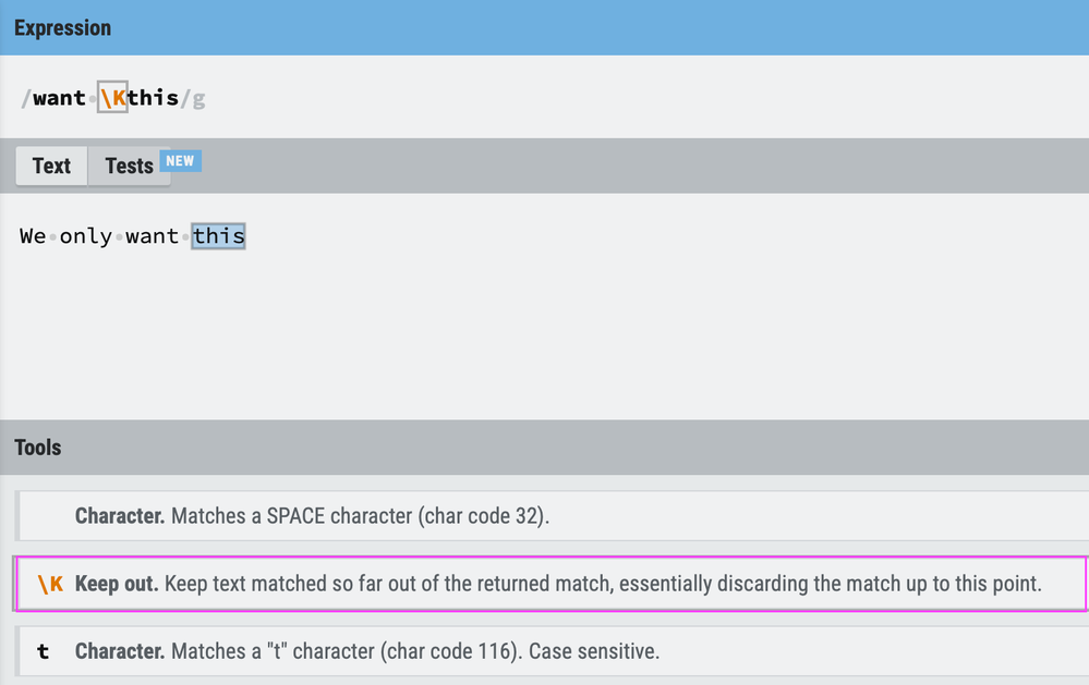

Yes Robert, I'm talking about \K. The first two links you posted give wrong information. It is not a "lookbehind" of any kind. The third post was correct.
But here's a more straightforward explanation, from regexr.com (my highlight in magenta rectangle):
- Mark
