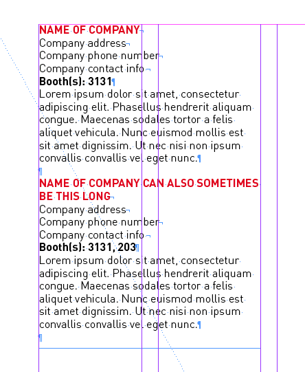

Hello all,
In InDesign CS6 I'm dealing with a bunch of listings for a directory. Each listing requires multiple styles and I'm wondering what GREP code might be used, if possible, to get the job done.
An example listing reads as follows:
     NAME OF COMPANY
     Company address
     Company contact info
     Company phone number
     Booth(s): 2129
     Description of company.
This is how the final should appear:
I've already created the desired character styles.
I need to format the name of the company, which sometimes continues onto the second line,
and I need to format each line that starts with "Booth(s):...", which is followed by a sequence of numbers.
The rest can be styled as body copy.
Any advice on how to get this done? Thanks a lot!!

Jan 22, 2017 Jan 22, 2017
Hi together,
finally with a lot of help from Obi-wan we can present a better way using three GREP styles.
1. For the first line holding the Company name:
NameOfCompany-Cap-Red
(?<!\n)^.+(?<=\n)
2. Another one on the first character in the line holding the Company name:
24pt leading
(?<!\n)^.(?=.+\n)
3. For the booth information:
Bold
(?<=\n)Booth\[s\]:.+$
Here an example of formatting using two GREP styles only where the formatting of the Company name will fail if the name is more than on line long and another example with the three GREP styles from above showing the desired formatting, but one has to watch out, that the long discription of the company will not contain any soft returns:
For some details on Obi-wan's thinking and interim exposed errors (typos on my side) see this thread:
With a single para style! …
Uwe
