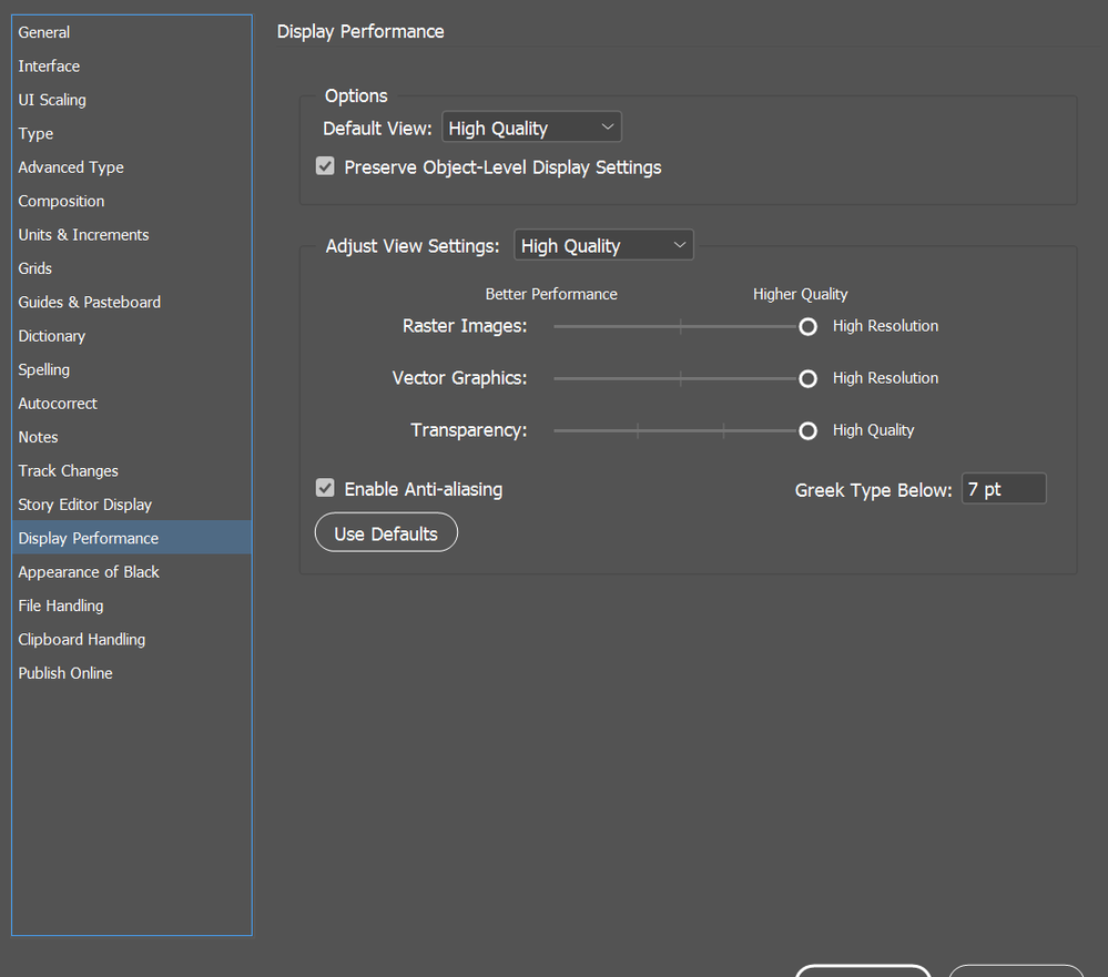

When I place images into InDesign my images pixelate and become low quality (Any files including psd, ai etc.)
I have gone to preferences> display performance and changed the settings but still no change. (Adobe InDesign 2020)
What should I do next?
Can you right-click on an image with the selection tool and confirm that the Display Performance section has the correct option selected? Alternatively, in the View menu > Display Performance, can you check what option is selected?
Finally, can you check the Links panel to make sure all the files are listed without any warning?
I assume all your images are high resolution and that's why they should all display in a higher quality.
Hi Eric,
I right-clicked and selected the correct setting. It was on "use view setting" and not "high quality display".
Thank you!

Hi Eric, I'm having the same problem with a vector I downloaded. It is behaving more like a .jpeg than a vector and giving me the same pixilation problem when scale up. Problem is:
1. I definitely selected vector when I downloaded the file;
2. I had already set the display performance to "high quality display" and based on your answer, I just checked the links and there are no warnings.
Adobe support is currently closed so I'm hoping you might have some answers.
Thank you in advance - Marie
