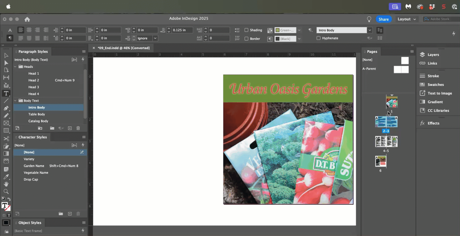

I head off this confusion by having all my students undock the Pages panel, keep it visible and focus on using it for page navigation. As you are belatedly figuring out, the blue highlighting is critical.
Below, I am showing with Mike is saying. (BTW, we are both InDesign instructors. As a matter of fact, Mike taught InDesign a million years ago because he saw the writing on the wall noting PageMaker's demise so much more quickly than I did.)
  • When I double click the page 2 icon, page 2 is selected and is centered. The page 2 thumbnail and the page numbers underneaath are both blue.
  • When I double click the page 3 icon, page 3 is selected and is centered. The page 3 thumbnail and the page numbers underneaath are both blue.
  • When I double click the dash between pages 2 and 3, the spread is selected and centered. The thumbnail for the spread and the page numbers are both blue.
To get to the A-Parent, double click the words A-Parent. Both the page icons and the words A-Parent will be blue.
I'm going to respectfully disagree with Mike and say you can also change the selected spread by scrolling and clicking/selecting—but you always have one eye on the Pages panel to be sure you are where you think you are. And Leo has an excellent example of the perils of the Pages panel in his second screen shot—the page numbers 4–5 are selected but the page icons on some other spread are selected. They need to all be blue.

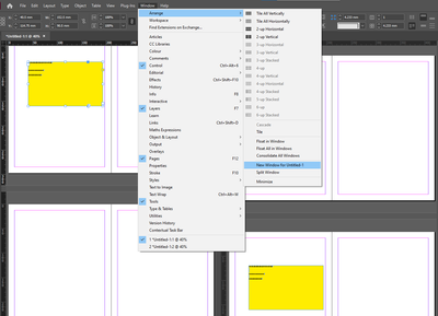

I'll even mess it up for you a bit more 😄
Of course, only ONE document / copy can be active - but you can use 2nd window to get a preview of some other part of the document - that otherwise would be unreachable - but your editing might influence it.
For example - edting Master/Parent Page - and see the changes in real time in full scale:
On the left - Master that I'm editing - on the right - live preview of the effects.
It's not "fully live" - you need to stop creating / dragging / resizing your element to get previews updated in the other window.
But when editing text - preview is almost instant.

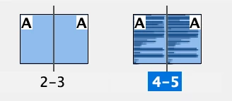

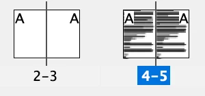

To illustrate the point made by @Robert at ID-Tasker, in the Pages panel you can select multiple pages or deselect all pages. Basically, in the Pages panel you can only reliably identify the active spread by its highlighted page numbers, but not the active page.
I do agree that it can be confusing in situations where the highlighted page is not the actual active page.

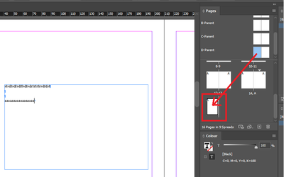

Just now I was reminded that there's yet another hole in this mess, making this
"in the Pages panel you can only reliably identify the active spread by its highlighted page numbers"
not true.
If you apply a parent page to a child and then add another page to your document, whoops: It doesn't add another page to your document. It adds another parent page, because using a parent page leaves it somewhat selected?
Therefore it is not reliable to perform all your page operations in the Pages pane. Oh well.
Screen grab of this ridiculousness attached.
